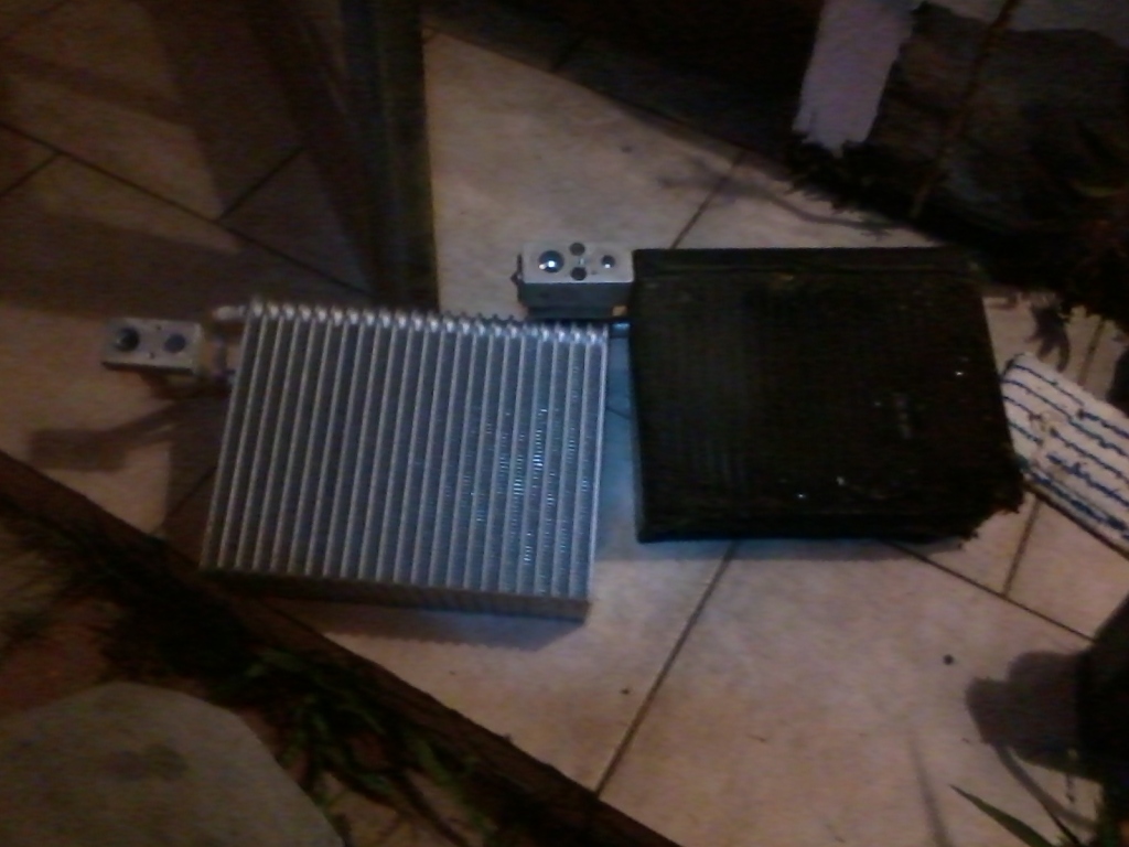

Originally Posted by blackvan
Sounds like an obstruction. I would inspect the intake air ducts and the squirrel cage for debris, then pry open the evaporator core housing and carefully clean off the dirt/leaves/etc from the evaporator coil. If it is seriously dirty and clogged (likely) you may want to consider replacing it.
I know something about that:
