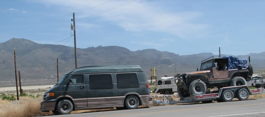

HOWEVER... As shown... now the ride HEIGHT is an issue.
I ended up going from 30" from ground to wheel well, to 33.5" inches!! (front is 30") i.e. I got a 3.5" lift on the rear... which is causing huge over-steer as well as a whole new set of groans and moans from the front suspension.

Excessive rear ride height can stress out the U joints more causing them to wear faster.
Longer Shackles will lower the rear and Lower the Cg making it safer.
Raising the front end will reduce handling as is raises the CG over the greatest mass of the vehicle
If you drive at night regularly, be sure to readjust the headlamps.
I replaced my Moog equivalent 7270 springs with 7272 which are thicker.
I did Not gain any ride height, but it no longer bottoms out and handles turns better, flatter, but rides rougher.
I'd replace the front springs with 7270 diameter springs to keep it from bottoming out and have longer shackles made to keep the original ride height.
I put firestone ride rite airbags on my tired leaf springs and adjust the ride height depending on the weight I carry.
100 PSI raises the rear over 4 inches compares to 5 psi.

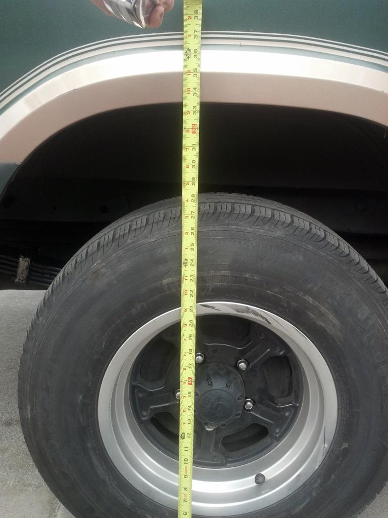

Thanks for the reply... Actually I have no idea if 30" from ground to wheel wheel as measured in my picture above is normal or not on the front, do you know? Maybe the front has sagged... I do know it's the same height it has been since 2005 when I bought this 1999 Van.

My preference would be to just get the rear end back down to "normal" height which for my van appears to be 30" from ground to wheel well as shown in my picture above. Any idea if 30" is normal for you or anyone else? :-)

With my tired 7270 diameter original springs, my drivers side sat at 29 inches to the wheel well, the passenger side 30.25"
After new 7272's installed it sat at 30" DS and 30.25" PS
That was with 235/75/15 tires.
I have 30x9.5x15 tires now.
