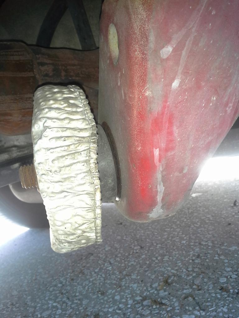

Well, after 18 months, it looks like my strut rod bushings are toast. I cannot turn the nut any farther (it didn't move in the first place)...but there is a good 1/8-3/16 of an inch of space between the bushing and mount (see pic)
It looks like they shrank ????? any they sure look bad eh? I am also getting a little clunking when I put on the brakes...this sure seems like the culprit.

Which brand did you install?
At least they are not too difficult to replace.
My Moogs came with a 1/8 inch thick plastic washer for where your gap is.
This is how the directions said to align the bushings and washers:

I know Napa still has the reputation of having the higher quality autoparts, but if they too did not go Asian, they would be out of business.
I think, if in your position, I would get Raybestos professional grade bushings to install, rather than finding a washer to use. I would not use metal unless you find rattling over bumps to be soothing. I do not think other brands use the washer. The Moog is a problem solver brand and apparently they thought there was an advantage to using a thick plastic washer on the back side.
If you want to make what you have work for a bit longer, I'd get a cheap plastic cutting board and use a drill and a hole saw or saber saw to make my own washers to fill the gap.
But the gap is indicative of the bushings breaking down. These bushings effect suspension caster, and will add more stress to the control arm bushings when not upto specs.
Control arm bushings are NOT fun or easy to replace.
I am not so sure my Moogs are holding up well. They break down internally first. Mine have a thick metal washer which fits in the part which goes through the frame mount to keep it centered. The rubber wore off mine and started squeeking until I pulled it off and used some Syl-Glide on it.
Silicone grease does not eat rubber, like petroleum derived grease will.
I think there are some companies which make Polyurethane bushings for these, but this material is harder and will transmit more road vibrations to the vehicle, but should make the brake feel better.

I went back to Napa with the "Master Rides" and bitched...I ended walking out with polyurethane NCP (Napa Chassis Parts)...
They fit well. After taking the old ones out - yes they were worn.
I also would like to confirm you info - YES it affects caster. I had thoughts of " I think I need an alignment." In the past month or so, the wheel had to be held in the 11-1030 position to go straight down the road. After the install of the new bushings today, I am back to 12. Also there is a lot less road noise. And the feeling or sure-footedness and good braking has increase significantly too!
Bottom line - don't get black rubber Master Rides
Thanks for the help! My van drives nice now!
