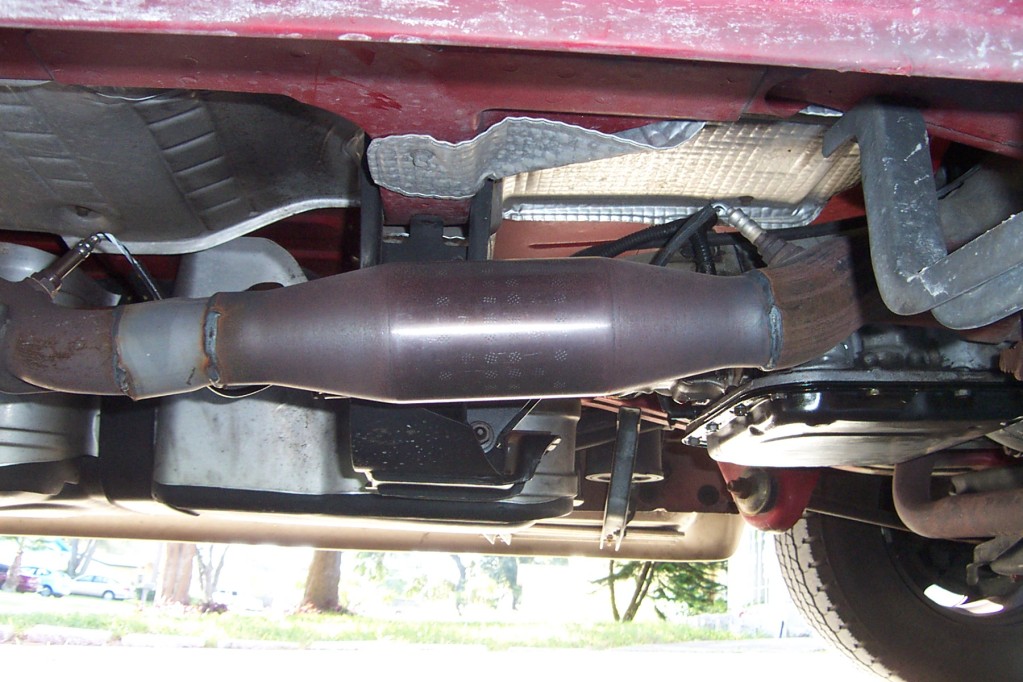

most cars do not rust here. My van has been here all its life and has ZERO rust on it. I also live 2000 ft from the Intercoastal...
here are some shots of the underside...
[img][/img]
cars don't rust through here. Yes, there can be surface rust, but this is usually from people not cleaning their ****
