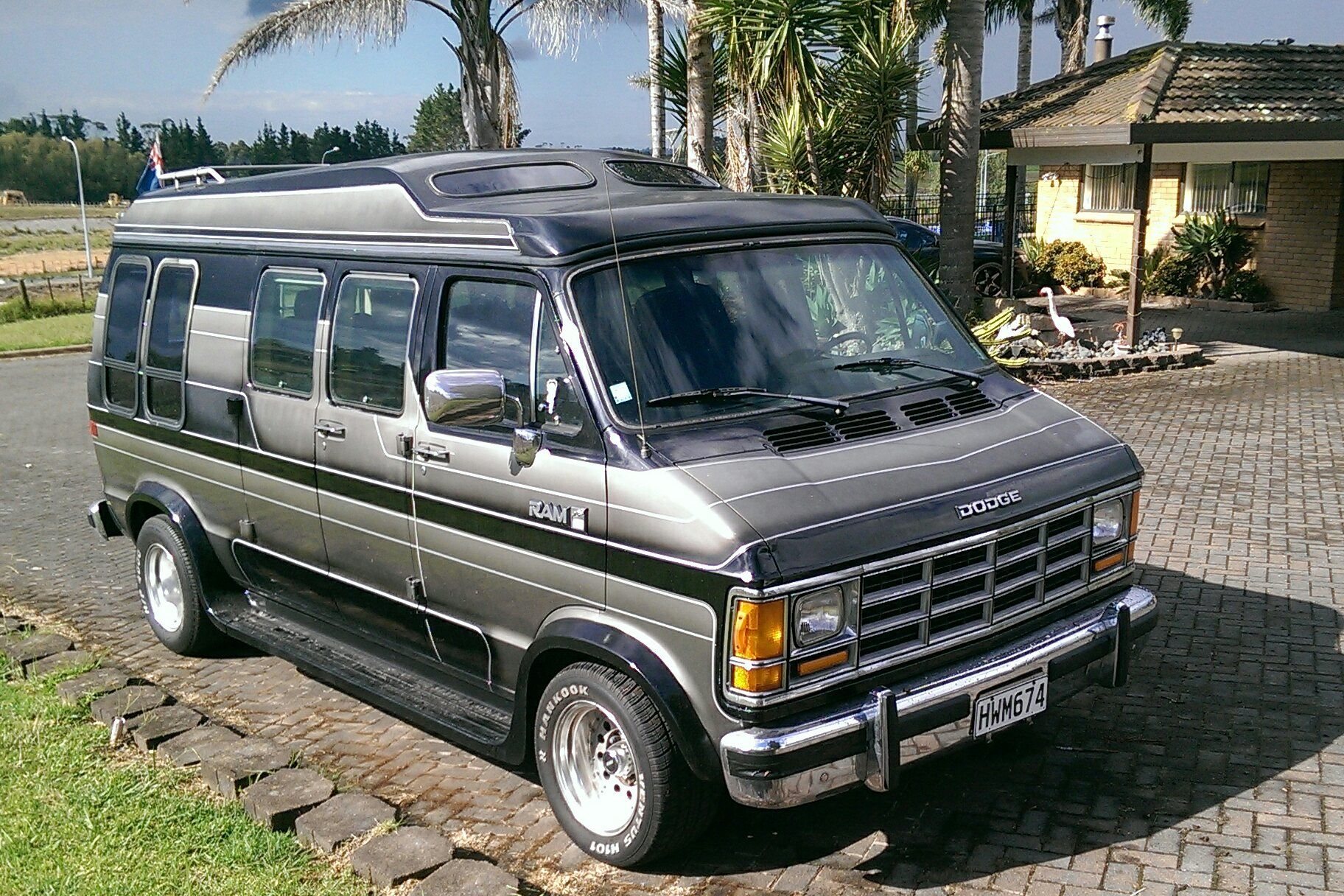

Hi,
First time here and wanted to say Hi and see if I can get a few questions answered.
Based in New Zealand http://en.wikipedia.org/wiki/New_Zealandand just bought a 1989 B250 360ci Day Camper as a project. The original conversion was done by Competition Vans out of Gardena CA.
No idea what my master plan is yet but want to start with a good tidy up. Some of the first questions are...
1. Where is the best place to source parts online for it? I have a long shopping list.
2. Wanting to update to full electronic ignition. Anyone have advice?
3. Do these have LSD installed from the factory?
4. Is there anywhere to go and find more of its history before it left the USA?
5. Any idea where I can get Owners Manuals and Parts lists from?
6. Does anyone know what happened to Competition vans and if there is an owners group for these or in general I can join?
Thanks for your time and if I need to spilt these up I am happy to do so.
Thanks
Aaron

Welcome aboard! Thats a neat looking van.
