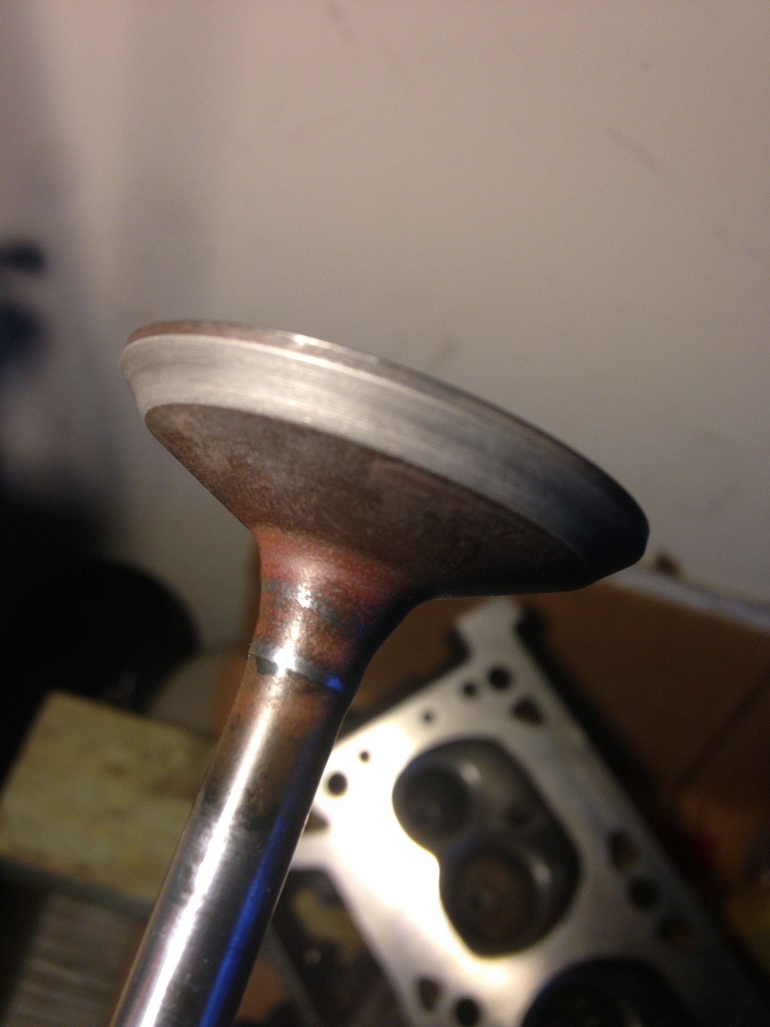

I've went the DIY approach and am trying to get the valves to seal.
below are pics of where I'm at -

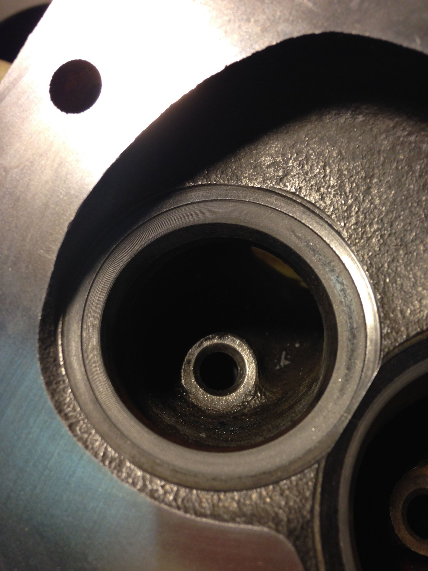

Here's My most urgent questions-
If I get down to that untouched spot (upper right corner of opening) will this seal?
The brighter spot in the upper right quad is where the grinding hasn't touched.
How's the valve? I just wanna make sure in the end these seal. again, I have time not money.
A bit about how I got to now....
I started with the lapping stick and have hit all the valves a couple times. The intake valves seal and seat great, I think they are made of aluminum or something. those were easy. The smaller exhaust valves are steel.
my arms felt like they were gonna fall off so i went to using a drill with a piece of hose. I saw someone on youtube do it this way. Seems safe and it works smooth as far as I can tell.

No, I'm sorry but IMO I would not expect this to work. However it is true that valve seat sealing can be tested with air after the cylinder heads are installed and torqued to spec, at least in theory.
If you have a 3.9L and your valves are leaking it usually means the heads are cracked and not repairable. If that is the case you will have to replace them .

However before giving up on it completely I would try the solvent test. Any suitable solvent ( toluene, acetone, even 90% alcohol) should be held by the cylinder head when it is placed upside down. This may assist you in identifiying the problem areas.
This normally works rather well for me. But please be extremely careful and raed the labels etc when working with volatile solvents. I really dont wish to hear about the resulting garage/house fire.

The valves rotate as the go up and down, so you do need to make sure the lapping is doing it's thing all the way around the seat.

Yup- this is what I was doing btw. I can see my problem areas. Just couldn't grind down far enough so Im giving up (something I don't do well)-
