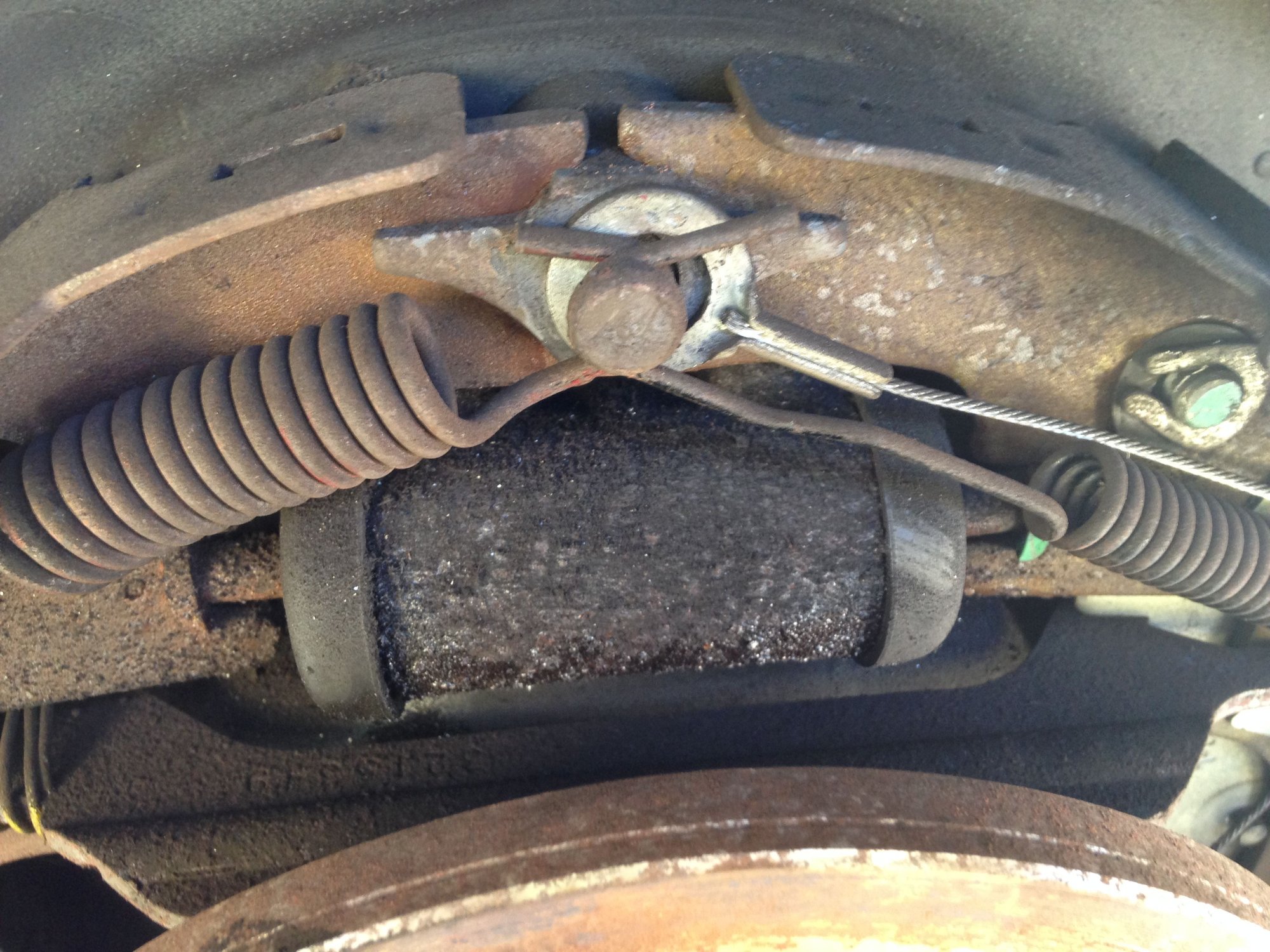

Just got the drum off....
The cylenders are toast. i'm surprised to see 1/4" of brake shoe left. It looks like some of the springs were replaced two or more years ago. I know I didn't do it.

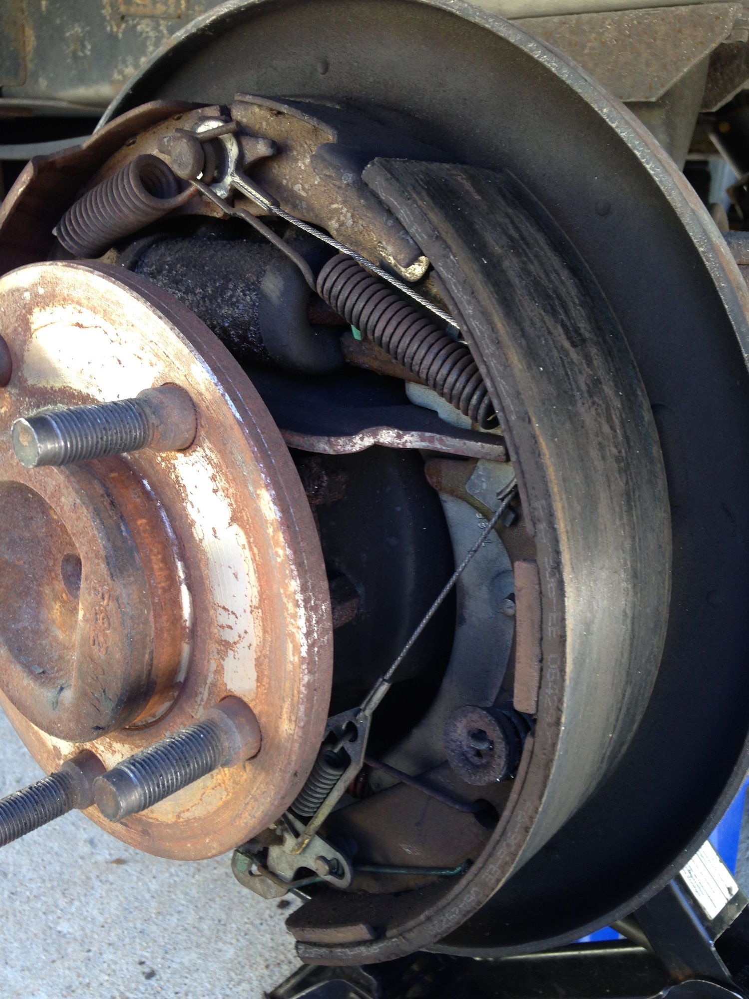

I'm a little suspicious of that uneven wear line. If they'll function right Id love to not spend the money on new drums. what do you think?
here's some other shots/ anything you see?

Depending on mileage.. I'd replace those drums if it were mine.

got 153K - cant afford it now but if i come across a good deal down the road Ill snag some.

If the pads are worn to the point of leaving grooves in the drums, then just as jkeaton already advised you will want to pick some new brake drums ASAP. You can get them at rockauto or amazon at a better price then locally. Taking numerous clear pics from various angles will be a big help during reassembly. I have personally replaced over a hundred rear brake shoes with nothing more "special" than 2 sets of vise grips and a very large screwdriver but watch your fingers.

I'm just not seeing the problem here. Except for replacing the wheel cylinders due to the leaking, I wouldn't replace anything else, it looks normal.
