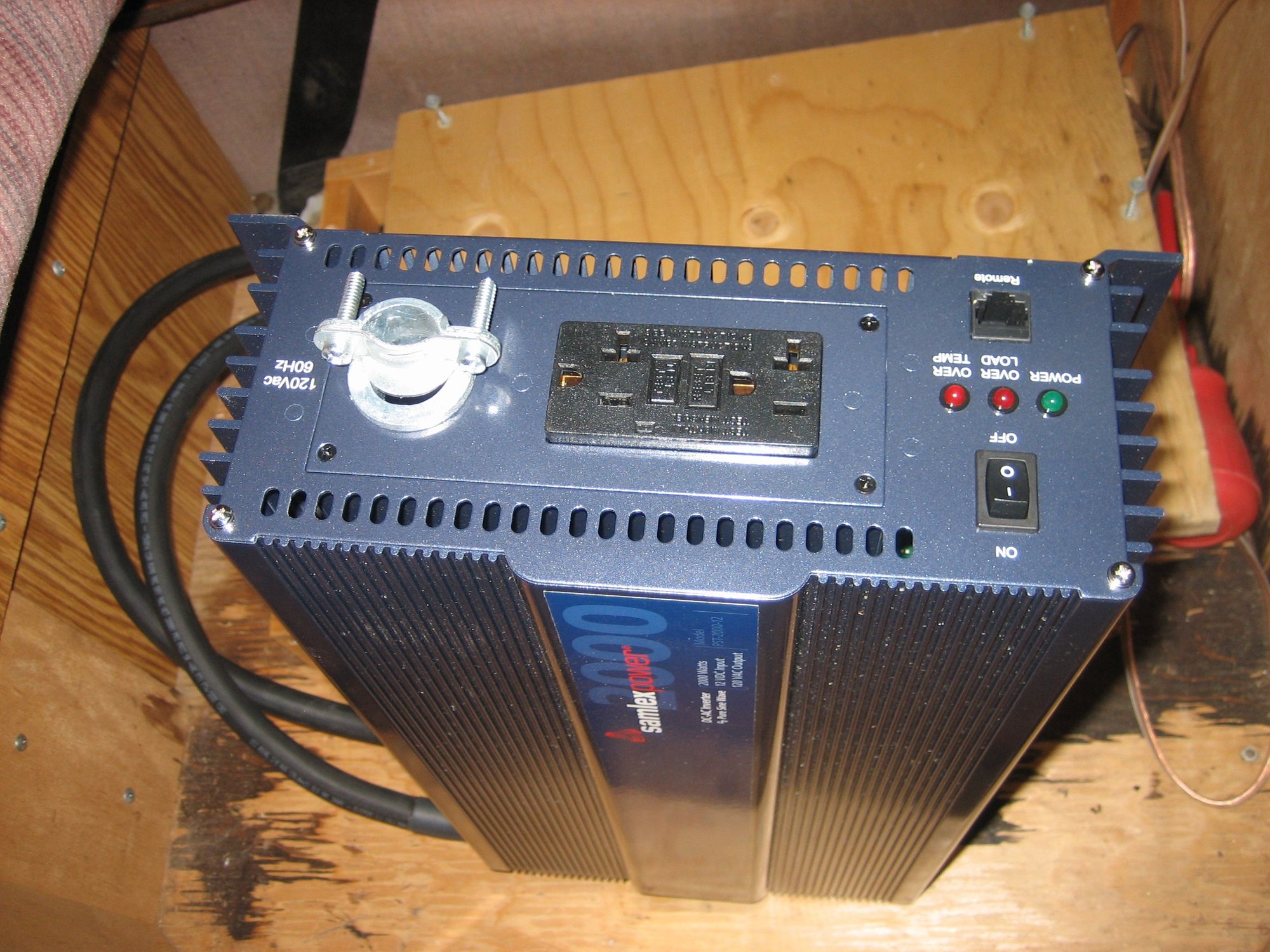

I worked a bunch of overtime recently so I decided to put some of the cash towards a new inverter.

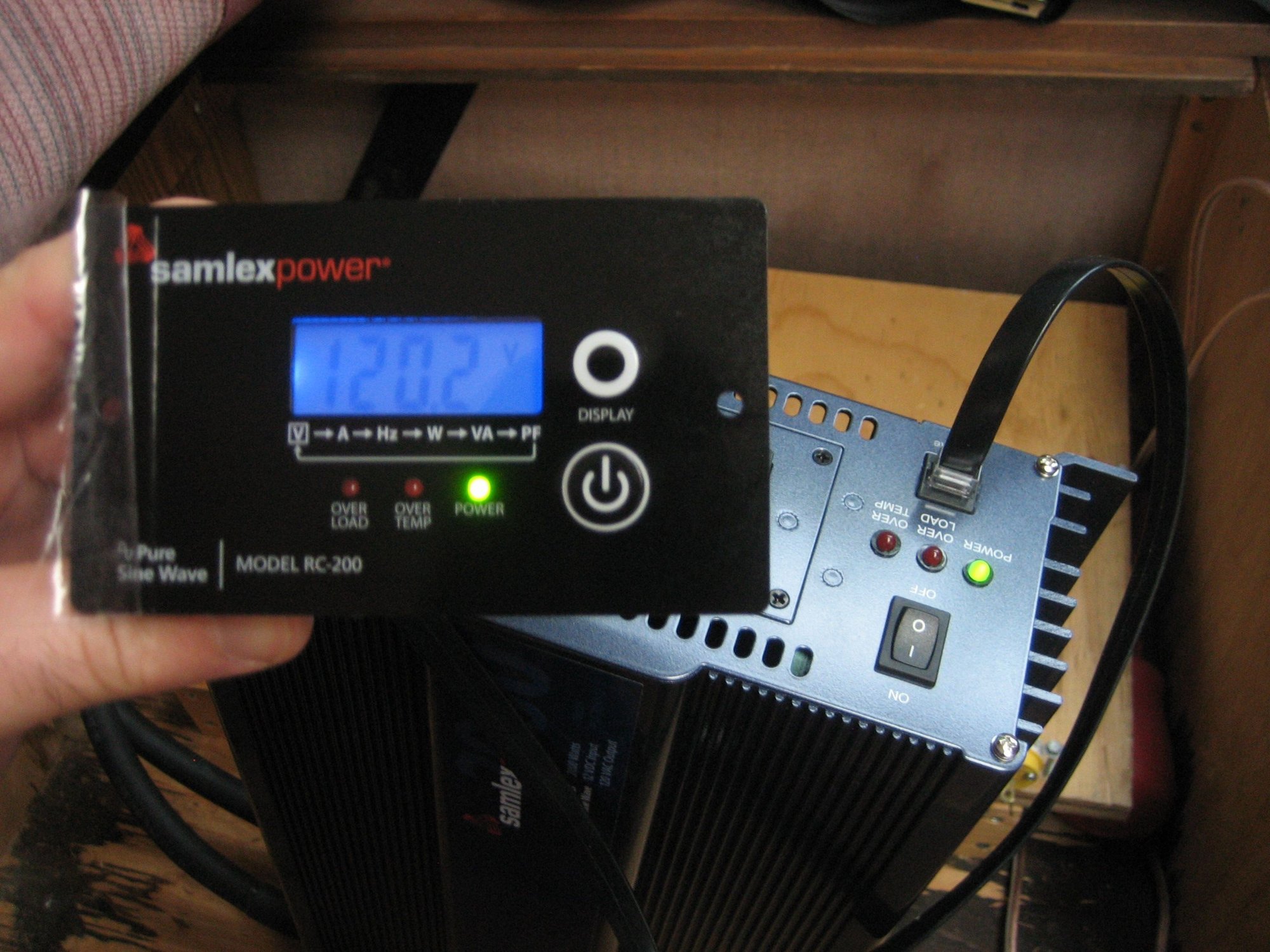

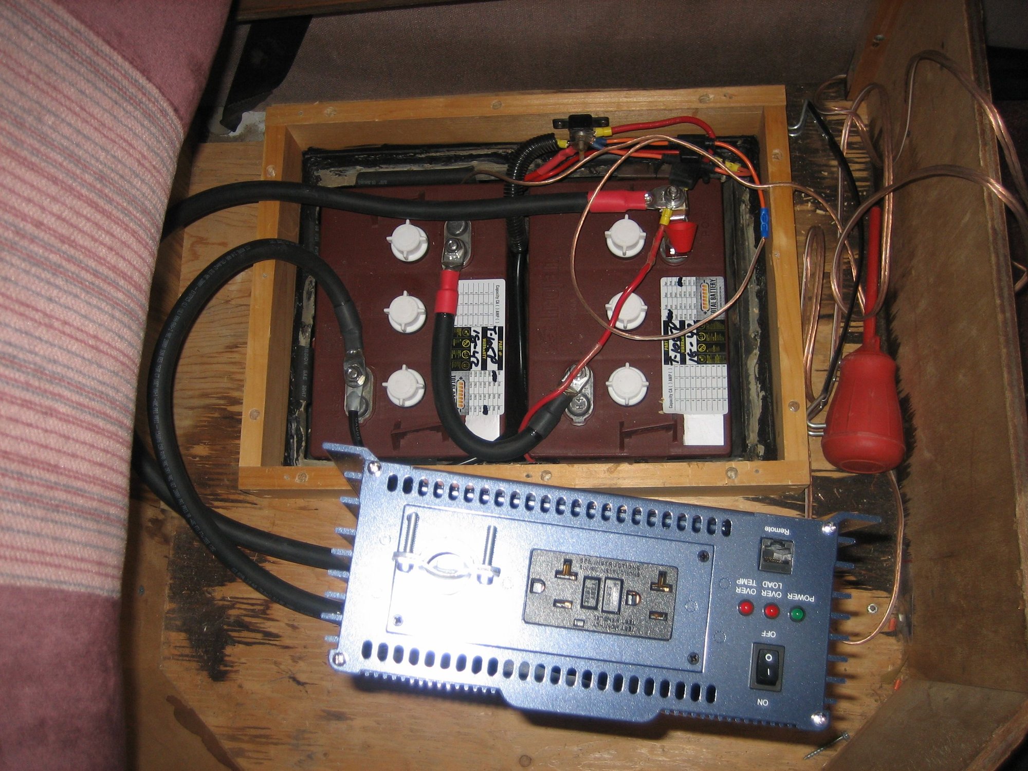

The new inverter is a Samlex PST-2000-12 with the accompanying RC-200 information screen. Cabling is 2/0 DLO protected by a battery post fuse. The batteries are Trojan T-105 Golf Cart batteries which I installed in the spring. They are pretty tall compared to regular deep cycle batteries so I extended the height of the battery box, I suppose I could have lowered the battery box to take them but doing the wood work was easier.
I still need to make some cords to wire into the van receptacles, add some ventilation, and some other minor stuff.
The reason I went with a 2000 W inverter is because I wanted to run a Keurig coffee maker when I'm in areas with less than favourable coffee choices. The whole installation will come inside the house for the winters so that I can use it to run the forced air gas furnace should the power go out for an extended period.
Cheers, Steve

lookin' good.
Do you think you need a vent in the 'box' area?

Yeah, both sections need venting but kept separate. The batteries are open to the drivers side exterior which is important to get rid of the hydrogen when they are charging. I need to make cut-outs for the cables so I can put the plywood cover down and ensure they are sealed to keep the hydrogen from coming up into the seat.
The seat the inverter is mounted in will need some venting too. The inverter is 85% efficient so it can make a lot of heat but I won't be using it for long periods of time.
I'll get it all figured out before the next camping season.

Landyacht, the T-105s are definitely the real deal, they are about 70 pounds each which is much more than the fake deep cycles everybody sells.
I am a bit disadvantaged when it comes to charging.
The electrical panel in the coach only has a 5 Amp charger and I think it tops out at 13.6 Volts.
The van does have a 120 Amp alternator but there is only a starter relay and a 30 Amp self-resetting breaker used to charge the coach battery from it so I'm at a loss as to why they sized the alternator that large.
At this point I am just going to live with what I have for charging and let the batteries suffer. I'll look into a new charger or proper high-current battery isolator if poor charging prevents me from getting what I want out of the Inverter.
If they made 100 Watt flexible stickers I could put up there I would go that way. I'm not big on adding brackets and holes to my fibreglass roof.
Cheers, Steve

Run some fatter wire from alternator to house battery over whatever type of isolator you use. If the isolator has large finned heat sinks, well, there are much better isolators which will not drop charging voltage by 0.6 volts.
