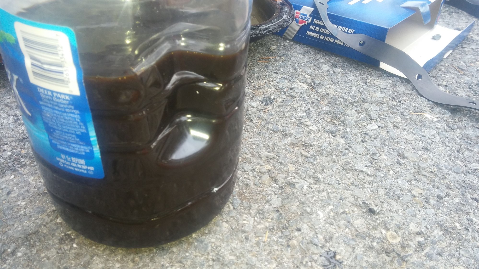

This is what the fluid looked like i changed it as soon as i seen it was this bad

Originally Posted by Donald Bradley
[IMG]
ouch...almost looks like water or motor oil
looks like a bottle of prune juice to me, I have one in the fridge......

Posts: 313
Houston we have a problem!!! With that fluid hard to believe the tranny engaged/shifted at all.
