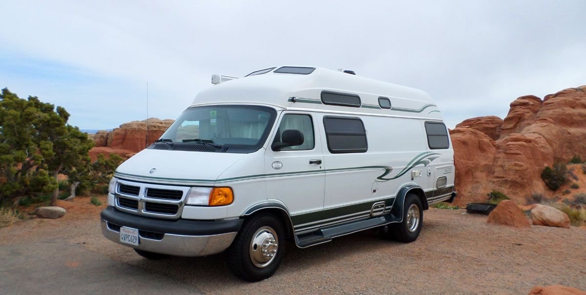

Hi Gerard. I just joined this forum after a search for a rear roll bar for my van, Which is exactly like yours , and even is a '98 as well. I have had several class B's, and is the third Xplorer I have owned. In my humble opinion they are simply the best American Chassis Class B's, period. It took me a long time to find mine; I have owned it for three years now, have made several modifications to it, and seriously doubt that I will ever, ever sell it. It's just the perfect RV for me. I'm interested in talking to you about them and curious which interior layout you have, but first of all:
Did you end up buying and installing this roll bar, and if so, did you see any improvement in stability, any drawbacks etc? Thanks in advance for responding.......
