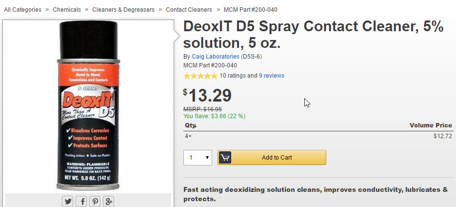

I am currently fighting a gremlin in my electrical section of my '01 van, that has yet to be resolved. Often electrical grounds get rusty on our vans and electrical problems start after 15-20-25 years of service.
Be sure to clean any ground connections you find and any corrosion on the connectors.
I use this stuff religiously... you can find it on amazon or order from MCMelectronics.com
Brother thank you so much for the info and help. I am going to order a can or two of that spray ASAP. I am working on the engine this week, replacing the intake manifold gaskets and anything else that may cause a vacuum leak. Like hoses and rubber connectors and plastic lines. But I just have a feeling this van has some issue related to the electrical system as the "Check Engine" light is burned out. Not a good sign.
