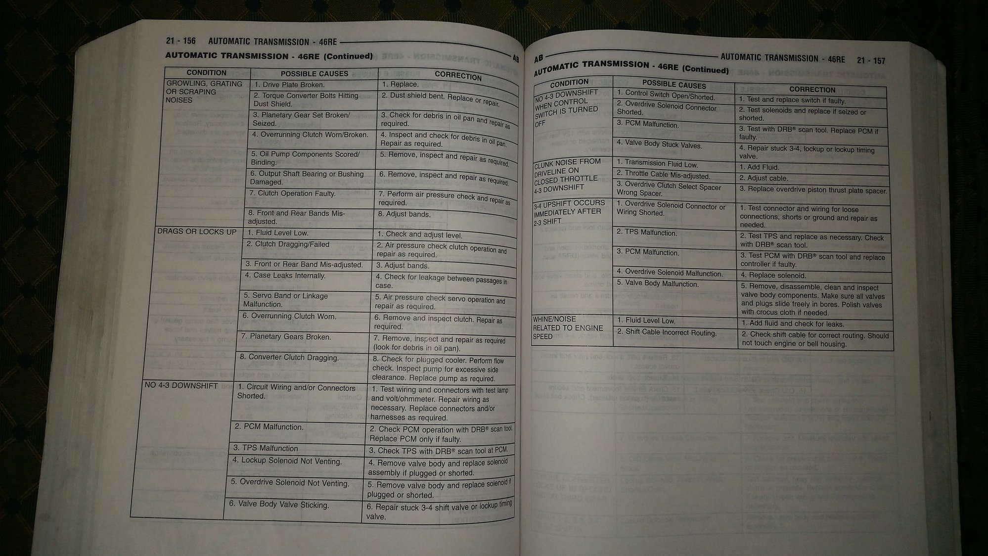

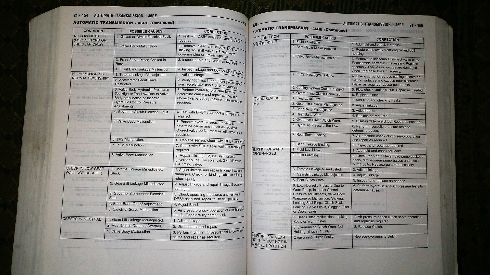

Thanks for that funair it's appreciated, think it would be a good idea for me to start looking for an fsm for myself too.
