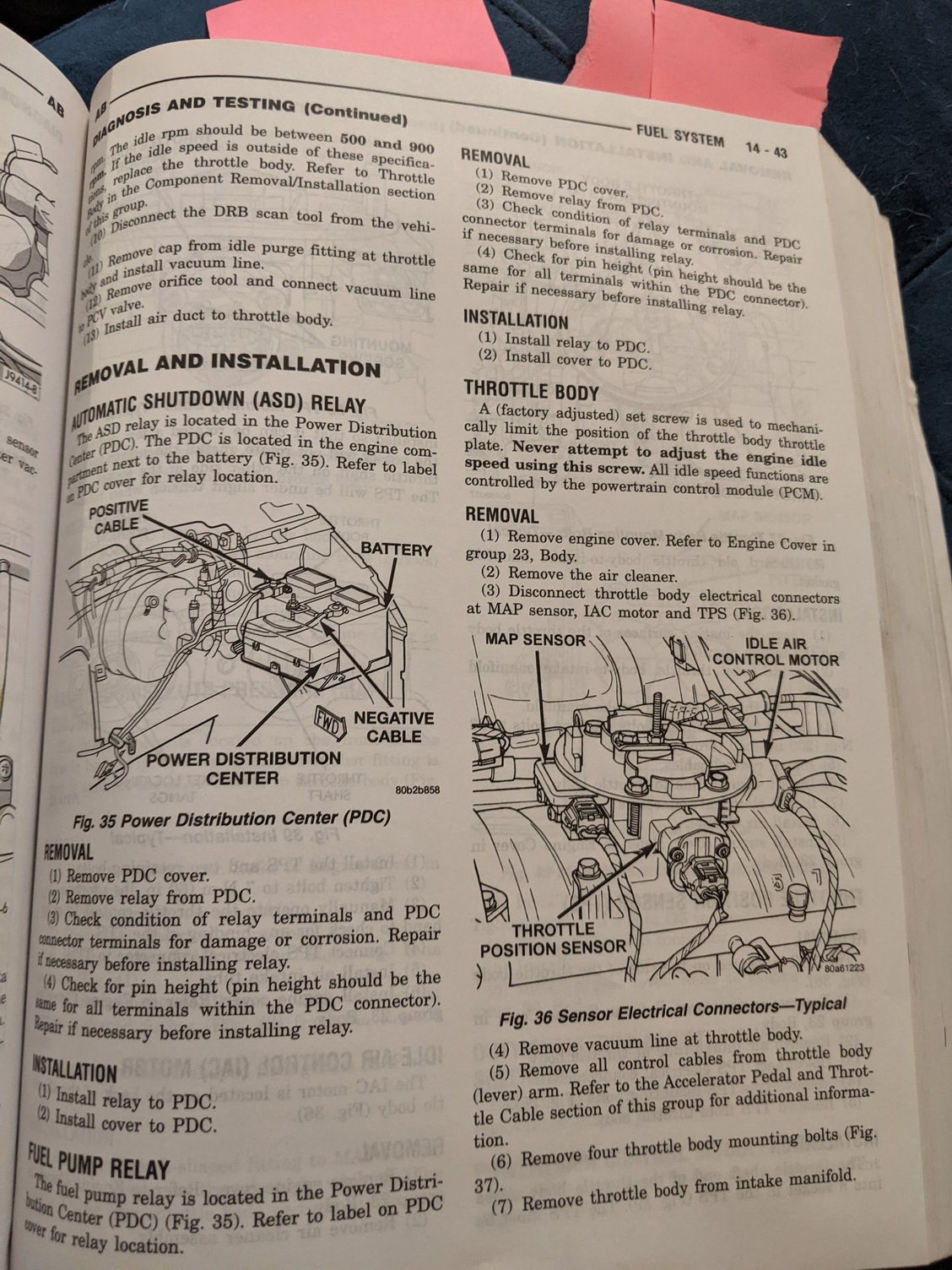

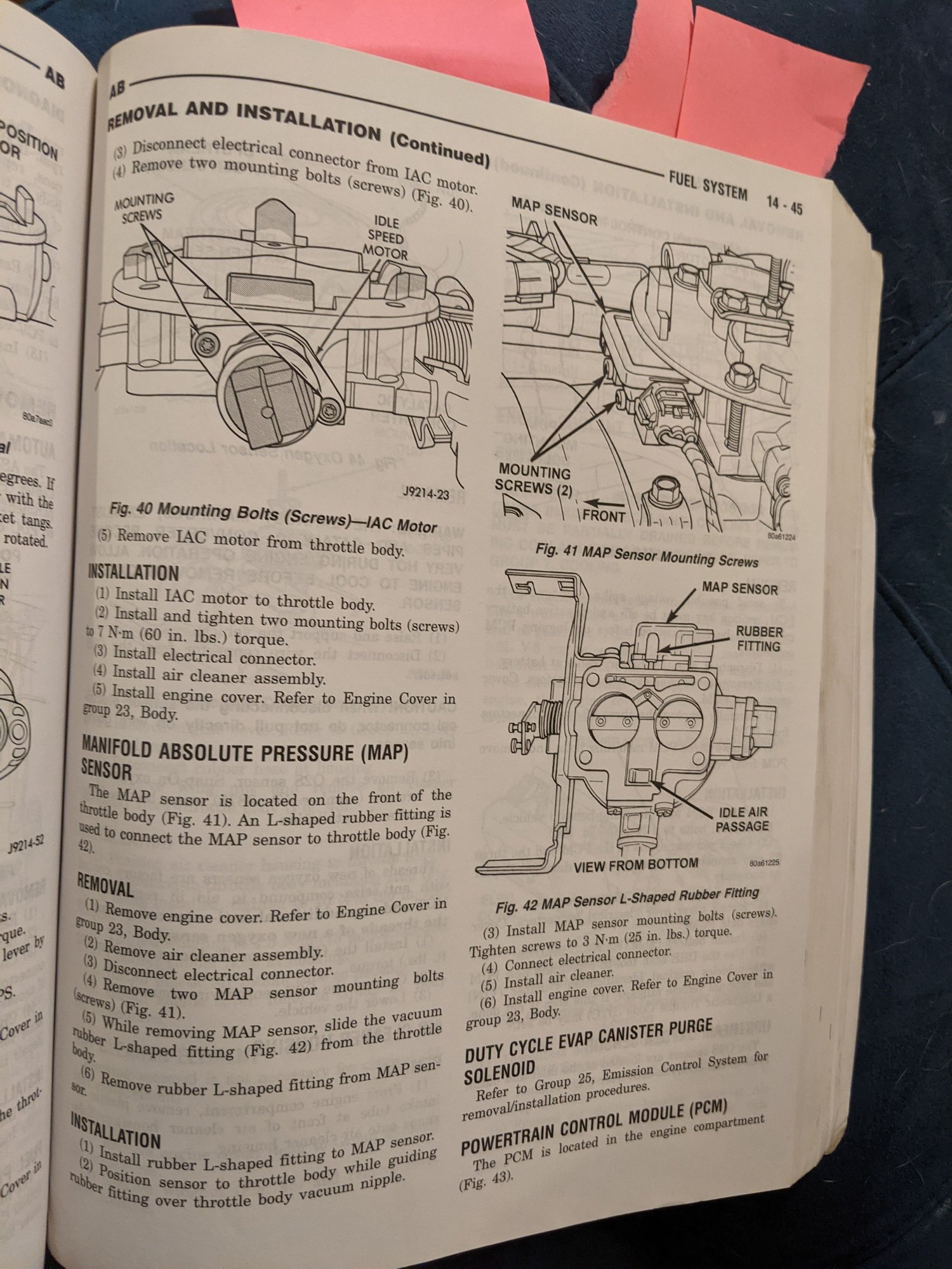

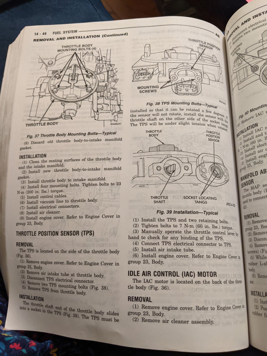

Hi. I don't know if you fixed this, but I have a 1999 and it exhibited a lot of the same problems until I replaced the battery and the alternator fuse, even though the battery appeared fine per voltmeter upon starting it would lose charge over time without liberal use of the gas pedal.
Also I have the IAC procedures in my service manual if it helps, and models 1998-2003 in theory shouldn't be that different:
Diagnostics:
Removal and installation:
All times are GMT -4. The time now is 03:05 PM.
