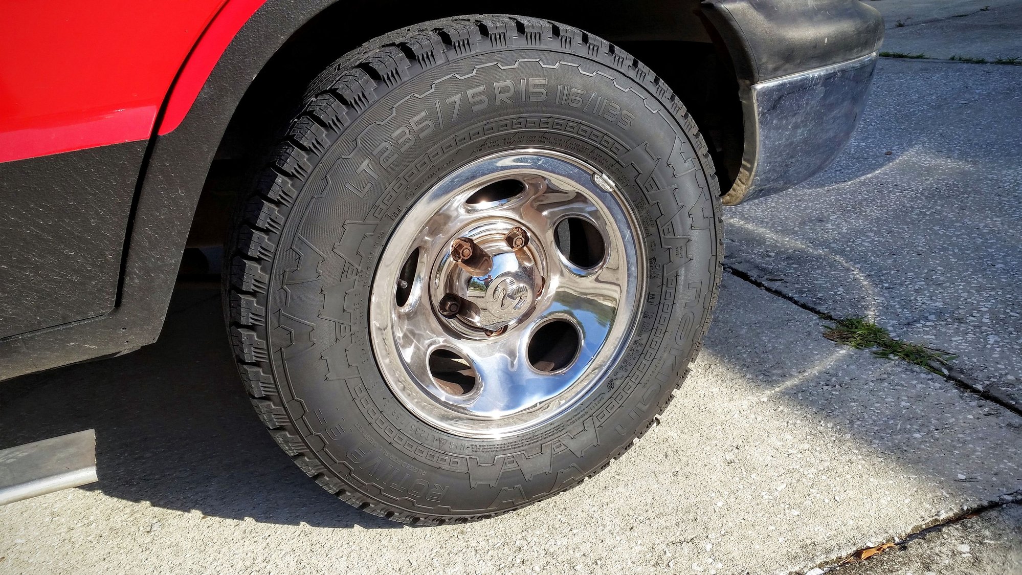

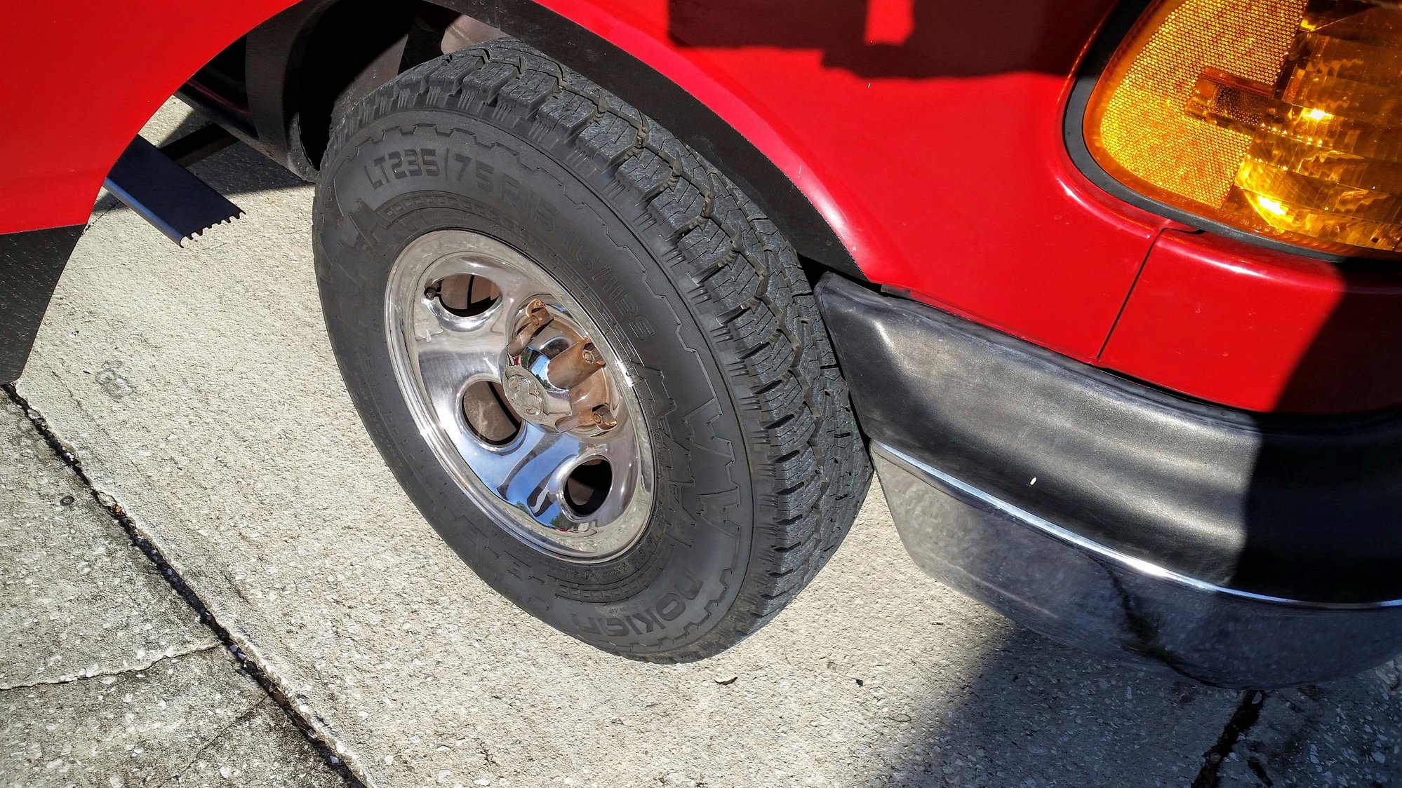

Originally Posted by RacerHog
Guess we will all know in about 20,000 miles.... Keep us posted....
Here are some pics. Please excuse the just out of the warehouse look. LOL
I was on the interstate today. They handled fantasticly at high speed.
I am still trying to figure out if these tires are that good or am I having a tire-on. LOL
