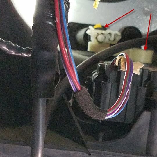

JFloors: I turned on the A/C and slowly cycled it through all of the settings. Each setting worked as it should, but the motor with the rod didn't move. (if I looked at the correct device; image attached).
And nothing else behind the glove box moved.
Arrows pointing to small motor

Steve I got it wrong! if you switch the dial between cold and hot then you should see some movement of the blend door opening and closing.
just an after thought regarding the 2nd item of your original post, using the vent setting only and it blowing hot air on a hot day. I can say that mine does pretty much same thing. Morning time and about 70ish the vent will blow about that same but afternoon and over 100 here most days this time of year feels like the heat is set to high
