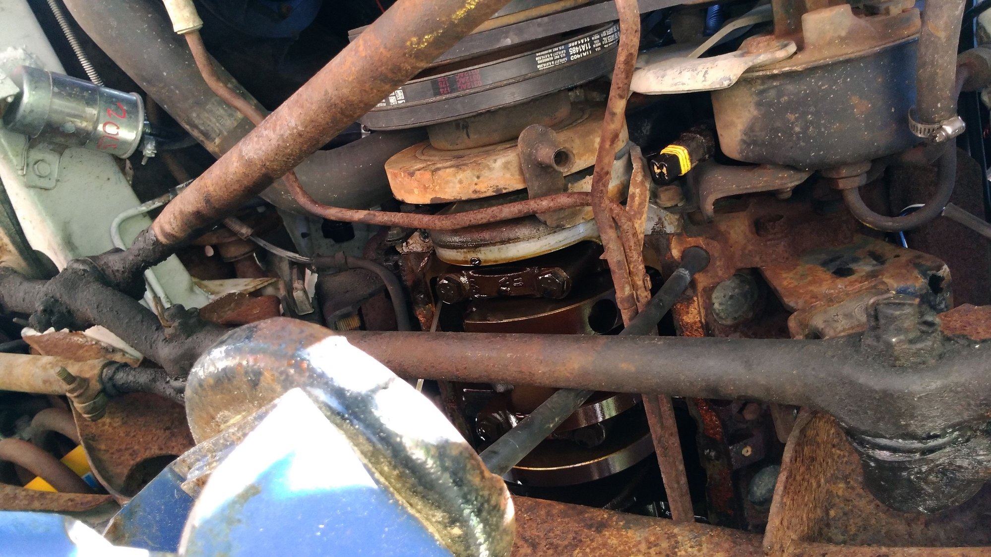

In the end I had to remove the fasteners on the engine mounts, the driver side stiffener below the starter, and then jack up the engine. I used a long 3/8" drive extension on the jack but it bent...should have used a 1/2" drive. After you have it lifted up you slide the pan backward and it'll just wiggle out under the y-pipe.
I found that some of the rubber pan gasket from the front or rear had come loose and was blocking the oil drain so it wasn't anything major. The cork/metal part of the gasket was in great shape and very time consuming to clean up.

Absolutely clean, nothing to scrape or dig out. I have been using synthetic and the odd engine flush for the past few years so that keeps the inside of the engine in good shape. I was expecting to find something because the oil turns dark in this engine quickly but nada. I believe it was just as clean up top a few years ago when I changed the valve seals.
If I were to do this again...I would have changed the rear main seal too. I did not notice until I was checking for torque specs but you need to take off the oil pan and pull the rear main bearing to change that seal.
Getting the oil pan back in with the rubber seal portions attached to the pan was ridiculous. I had to mash the flexplate cover to get the pan in between the oil pump and the flexplate cover. I blew a lot of time trying to remove the cover which doesn't seem possible before I resorted to that.
