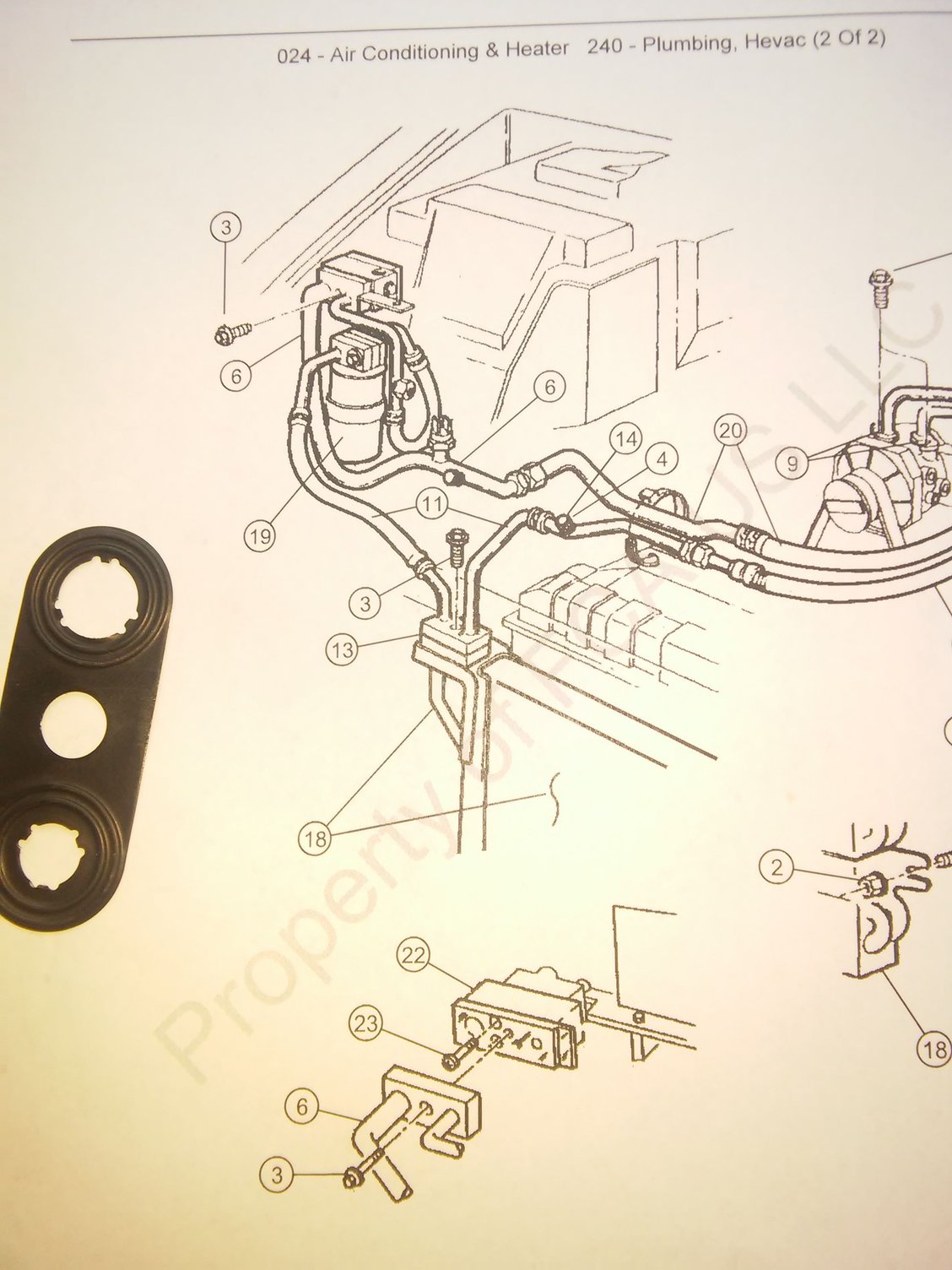

heres pic of the placement, its labeled #13 on the drawing, also, thats the gasket that the dealer says goes there on the left.
I have cleaned both surfaces religiously. I suppose it could be warped since its 20 yrs old. Is there something i can use to try to seal it along with t
he gasket? I have tried doubling up and it still leaked.

Doubling the gasket will just make sure it leaks. I don't think there is any kind of sealer that will stand up to the pressures...... Could put a straight-edge on it, see if it is warped......
