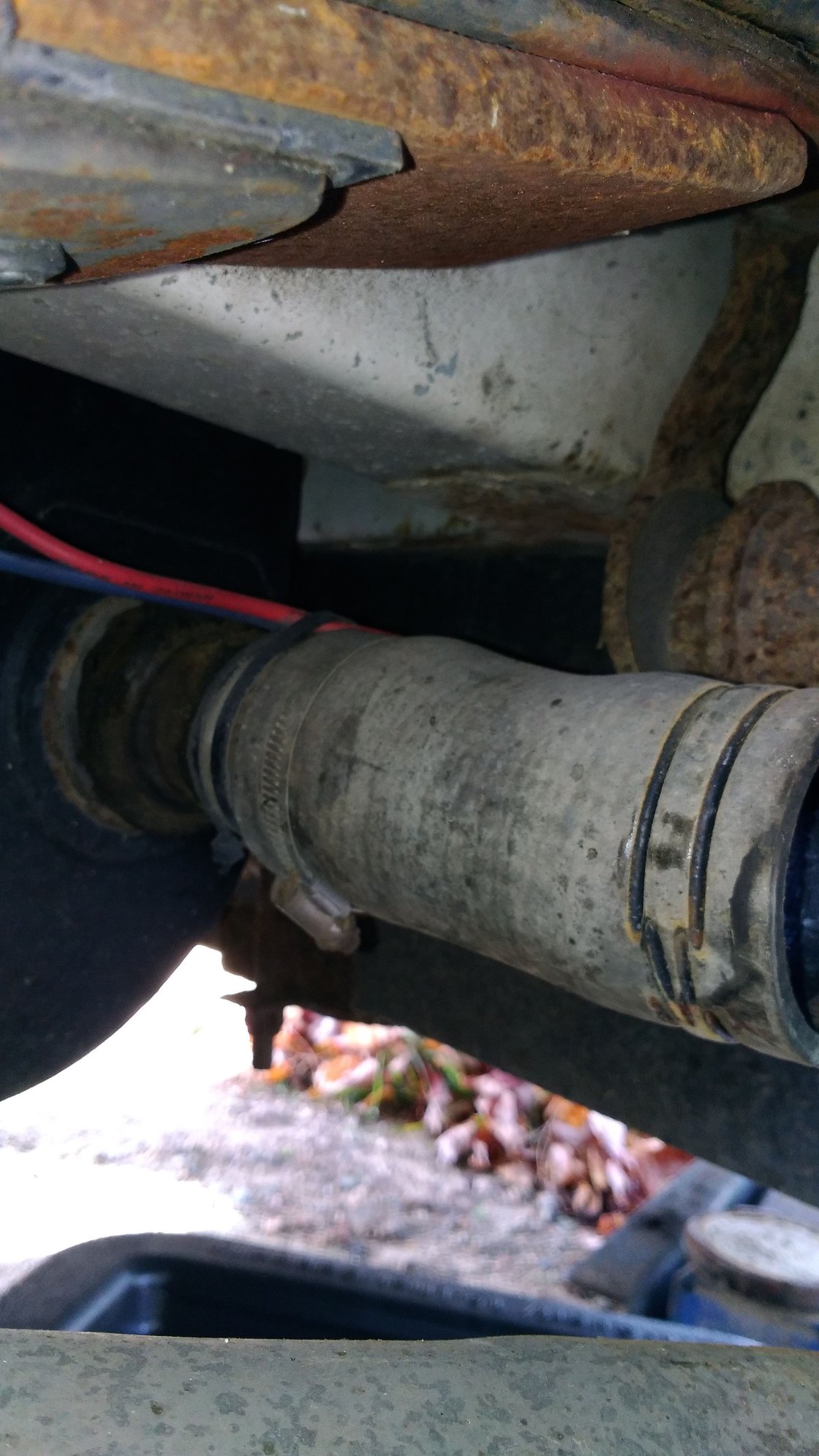

Old Oct 26, 2018 | 07:42 PM
SteveR's Avatar
SteveR
Joined: Jan 2009
Posts: 547
From: Ontario
Finally got back to this. I removed the fill pipe but found it wasn't blocked at all. The hoses were not either. What did surprise me was that the pipe that "connects" to the tank is just stuffed in through a foam gasket! I decided to paint the pipe as its somewhat expensive. I did add an extra gear clamp on the foam as it was just a slide fit and was kind of weird to me. When I went to fill up the tank I didn't get any overflow but the gas station I went to was very slow at pumping. I filled the van with premium for the winter so I won't know if this worked out until next summer.
