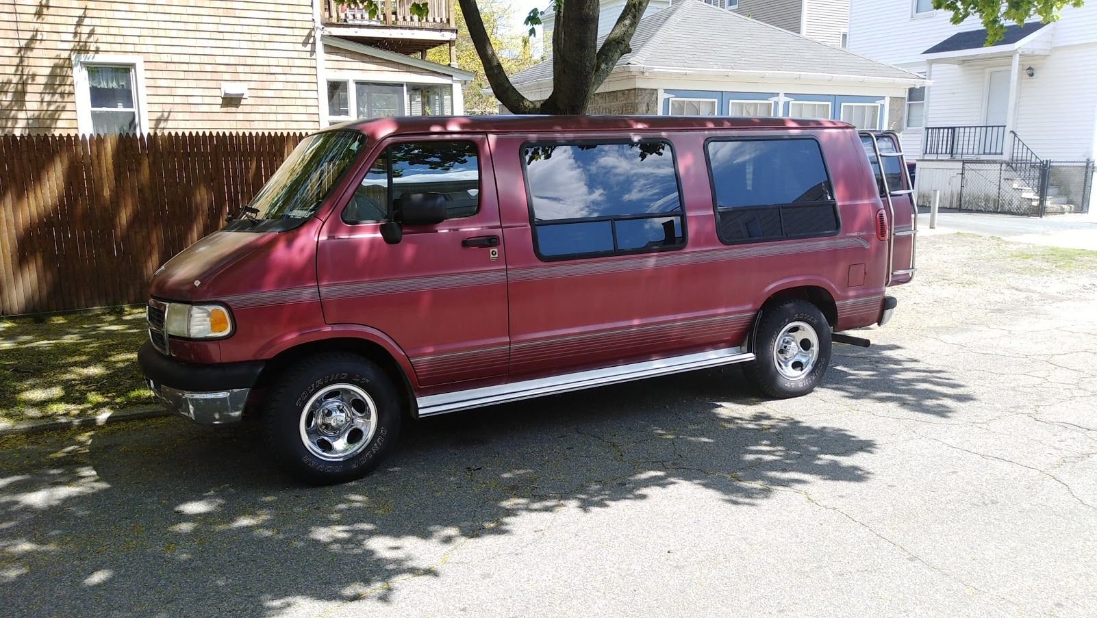

So I'd like to give my girl some OEM or just as if not better tune up parts. I'm at 97k and have noticed a stutter around 65 on the hwy. Could be a lot of things yes but I just redid the plenum, ICA,TPS and some other things and I'd like the PCM to feel some new parts. Last tune up was previous owner and I can see he used sh&t parts NGK's and a cheap cap from AZ.
So any recommendations for plugs, cap, rotor, wires and such would be appreciated.

Don’t have any advice on what you are asking but just wanted to say what a nice van that is. I’m glad there are people keeping these things on the road. As the saying goes, they don’t make them like that anymore. I love those vans.

Thanks Jkeaton. I love her man. My pops had one just like her (88') and we had a lot of good times in it so I wanted to pay hommage and he's passed but keep a few pics on the dash to ride with me. Would love to have the 88' with the all white and blue stripes and raised roof.
