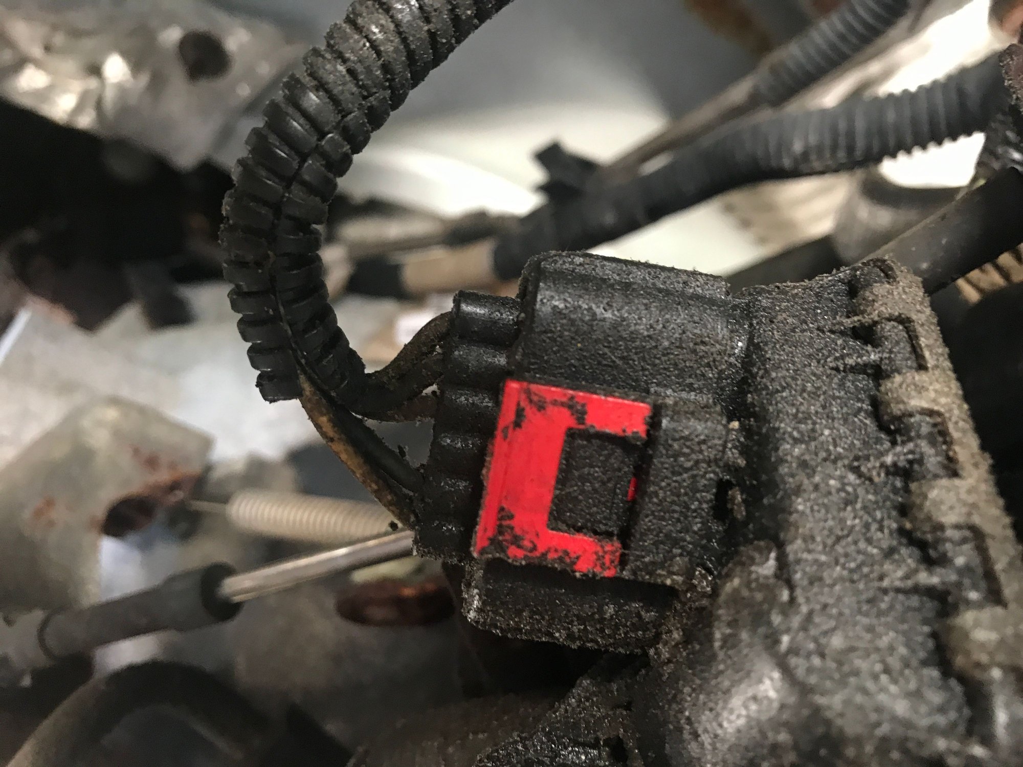

Old May 4, 2020 | 01:20 PM
jbrettcarver's Avatar
jbrettcarver
Joined: Jul 2009
Posts: 16
When I disconnected this connector there was tranny fluid on the inside of it. Could this cause it?
Old May 4, 2020 | 02:05 PM
jbrettcarver
Joined: Jul 2009
Posts: 16
Looked at wires and found nothing.
This plug had tranny fluid inside the plug.
Checking the fluid it seemed really high. Do you check the level with it running or is this on of the exceptions? It was warm and level.
Old May 4, 2020 | 03:54 PM
Posts: 87,267
Likes: 4,197
Probably wouldn't hurt to clean it out. I *think* that is the connector for the P/N safety switch? If its leaking, time to replace it.
That said, that isn't your problem. Though it may be a contributor.
