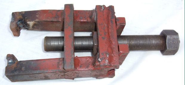

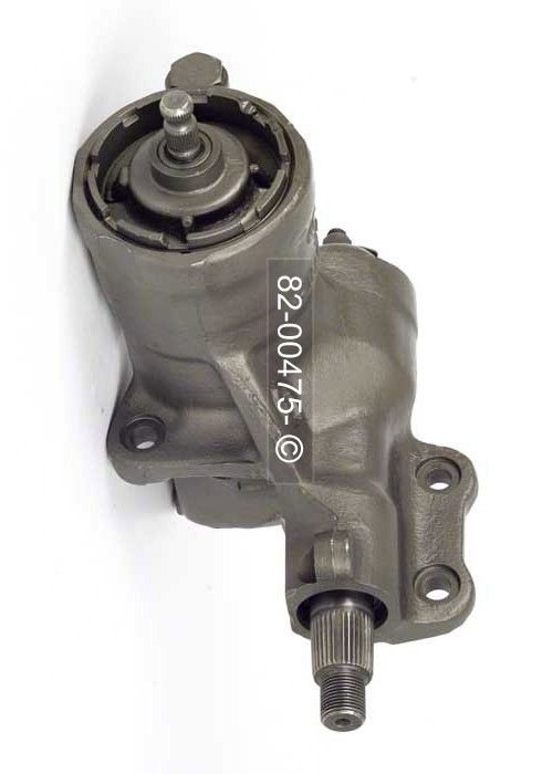

I did this on my '79 B100 (318) back in 1983. Went to the junk yard and got the box, pump, plus hoses, mounting brackets, belts etc. It was a direct swap, nothing else needed changing. Mine had an air pump so I needed the PS pump brackets to mount at the two o'clock location. There were enough pulleys on the crankshaft to keep everyone happy.
The first box I installed only had power assist turning left, so had to go back for another. I got a low mileage box this time off of a 1979 Chrysler wagon (the one with the fake plastic wood on the sides), it worked just fine. The same box is on both cars and vans. Be sure to check for wear on the worm before you buy. Wind it through L>R manually and watch for any roughness in the center position, that is the place for the most wear.
If you remove the bolts from the floor and get the steering coupler loosened from the box, you can pull it right up and out of the way. I might have reused the Pitman arm, I know some of them are different on cars.
A picture of the box, the coupler (with an added grease nipple) and an ugly Pitman arm puller that I made.
