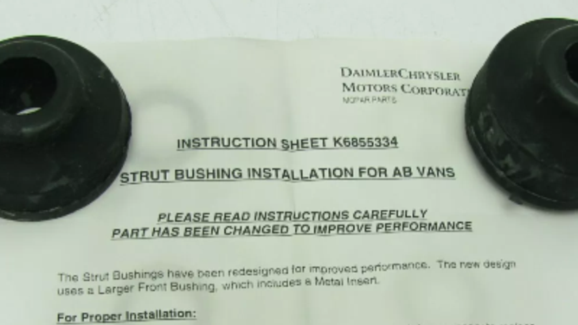

Old Jul 19, 2019 | 02:20 PM
arty4444's Avatar
arty4444
Joined: May 2017
Posts: 274
Likes: 7
Ordered my OEM strut rod bushings and thought it significant enough to post that apparently the factory has changed (improved) the original design of these bushings at some point in time. Maybe that's why it seems to have been a problem area for original and aftermarket bushings. Wow- my van's going to ride better than new!
