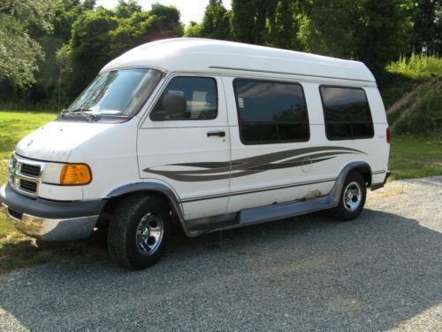

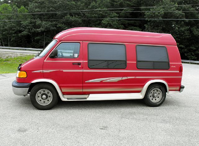

Below is what I think the van looked like with the body kit minus the high rise roof cap. I have not found any photos yet of a Chariot conversion van without a roof cap.
Notice in the white van there appears to be some rust above the side panel.
