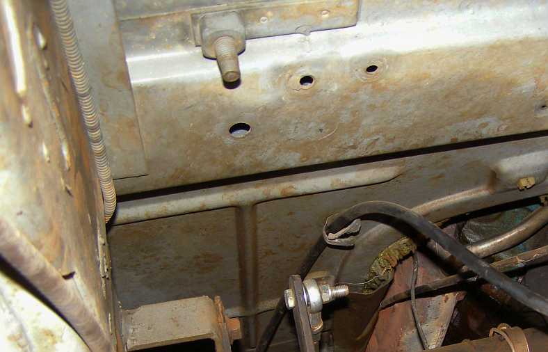

If it's similar in build to the earlier vans, those seat mount bolts come through a doubled piece of panel, the front seat bolts go through a flange in a stiffening rib which goes across the vehicle, the rear seat bolts are through the similar flange in the main transmission-mount crossmember. And then they have a small piece of heavier gauge pad to give further strength. This pic is the same bolt on the driver's side:
Even if it's not the same it won't be too far removed from this. So for that to have pulled through you will surely find that there's a significant area of the floor under the seat which has been badly rust-affected. That's what you have to fix, in my opinion,
Personally I don't like the idea of putting hefty pieces of iron in there, but it is the sort of thing that a decent exhaust man with a handy MIG and some panel steel could work on from the top, cut it all out and then build it as you go, if you have a friend in that business I'd pull the seat out , clear the carpet (if any) away and take it down to see him.
