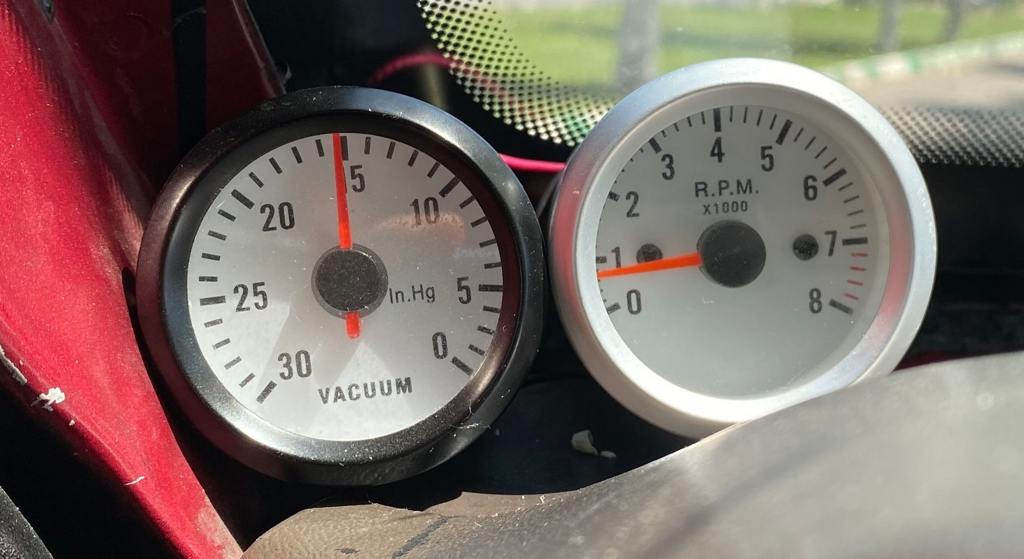

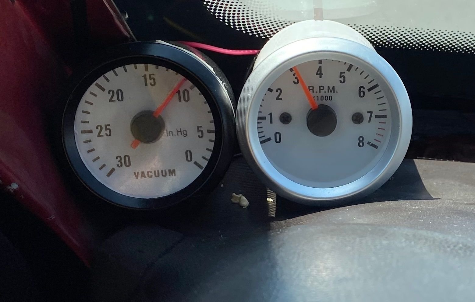

@HeyYou I have installed an extra vacuum and RPM gauge in this van - please find in the images attached the vacuum reading at 2000 RPM, 3000 RPM and hot idle.
What would be the ideal vacuum reading to aim for?
Vacuum reading 3.9L Magnum V6 @ 2000 RPMs
Vacuum reading 3.9L Magnum V6 @ 3000 RPMs
Vacuum reading 3.9L Magnum V6 @ hot idle
Old Jul 16, 2020 | 07:41 PM
Posts: 87,475
You should have higher vacuum at idle..... Should be closer to 20".
But, as far as "ideal" goes, the higher the better. Same during acceleration. You are going to see your highest reading at idle, with no load on the engine. You will see the worst when accelerating hard. (close to zero....)
