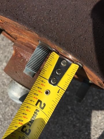

Some dimensions off my factory wheels:

Well, you were correct about the hub bore being 3.5". I just pulled the wheel and confirmed it. The info listed here: https://dodgeforum.com/forum/wheels-...ern-guide.html is incorrect.
