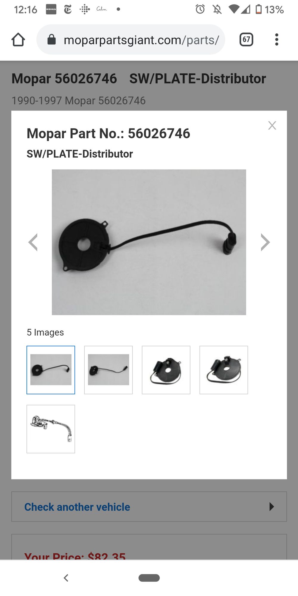

Default This may be that part?
I am trying to follow along in case I need to do this since I have a model similar to Eric's. If I am understanding this correctly it is this part:
Although it may be part #4379488 for you vehicle, there are two kinds for that year model
and it is #15 in this diagram:
Hopefully I am on the right track and this will help your mechanic find the right part.
That is the part , depending on the type, mine was the under the rotor type compared to the other view that is under the distributor. The initial problem was Auto Zone carrying ones that are basically a spacer with no leads attached. The counter person assured me there was no electrical connection and even pulled one from the shelf to show me it looked just like the exploded view on his screen with no leads .
Nappa looked at me odd when I told them what I was looking for then he said oh ya the pick up , they go bad all the time and threw me the same part that was on my truck with the plug.
when that thing was bad the truck woukd idle decebt and even cruise decent but any ramp or hill it wiuld miss or a a quick acceleration. seemed to get better after a tune up but started again after a few days right back to where it was. I coukd not get a code out of it until it finally would not stay running at all. I did not have my reader with me and did the key dance, I cannot remember the number but it was a combo I believe cam/crank sensor. The crank sensor was more expensive so I started with the pickup. No problems in well over a year,improved idle as well. Before it woukd only idle at around 500 and seem to want to stall at tines. Actually thought the low idle might have been q different issue like an injector
Don't know of this is your problem as well but I'm sure there is a way of testing that piece that soneone might know on here, I happened to be so frustrated I started throwing parts at it. Definitely worth lookin at . I belive the new one was 20 bucks

Truly appreciate everyone's response. I ask the mechanic about the cam sensor. He said we did change it... they called it the pickup. I'm glad it worked out for you Eric but yeah, no such luck here. And thank you Ruby for finding and posting the diagram - I appreciate it.
