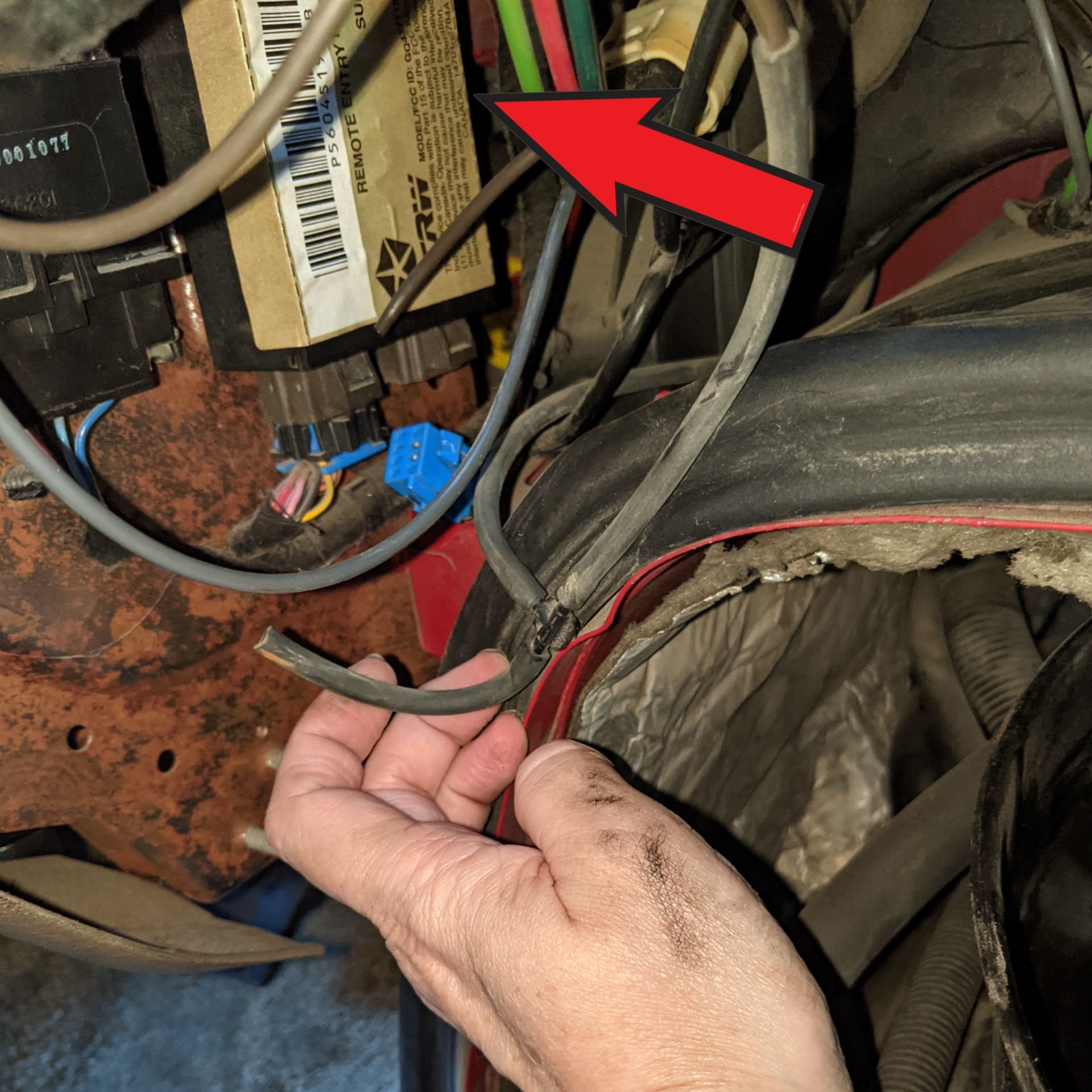

For the benefit of people that don't know if their van has remote key entry or not, in my 99 and probably other models, you would need to take off the doghouse (two clips on the sides and four bolts in the floor) and look on the drivers side right under the hvac controls on the dash.
If you have Remote Entry, there should be a module clearly labeled that. Arrow points to the module. The loose blue connector plugs into that module, in case yours was like mine and disconnected:
Old Aug 23, 2021 | 05:43 PM
