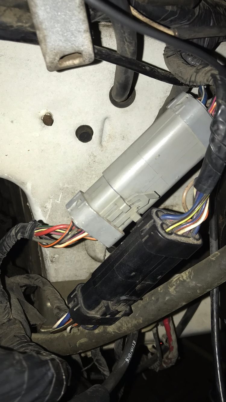

4.while looking for the dead short I noticed when I unplug 1 of 2 of the main harnesses under the hood it allowed me to put a new fuse in and it wouldn’t blow it for another week or so.
5. so this is where I am at now. I can start the van and drive but if I give it gas like taking off at a red light fast it will blow the fuse. The fuse will continue to blow until I manually unplug the gray or black harness under the hood and plug it back in. I want to add if I am in park and I rev the motor on the high end there’s a second of silence like the motor is shut off and turns back on. I don’t think that’s what happening but something happens when I rev the gas that causes a brief 2 seconds of silence sometimes it will return to running or it will blow the fuse when the gas is revved up. Hope that makes sense. It’s a window of 2 seconds at the high end of the rev where it goes quiet and seems it’s stalled. Thanks for any input.

Last edited by Aceofpaints; Nov 8, 2021 at 09:33 AM. Reason: More info: the picture is the 2 harnesses I am referring to that when unplugged and plugged back allows me to restart the van with a new fuse.
