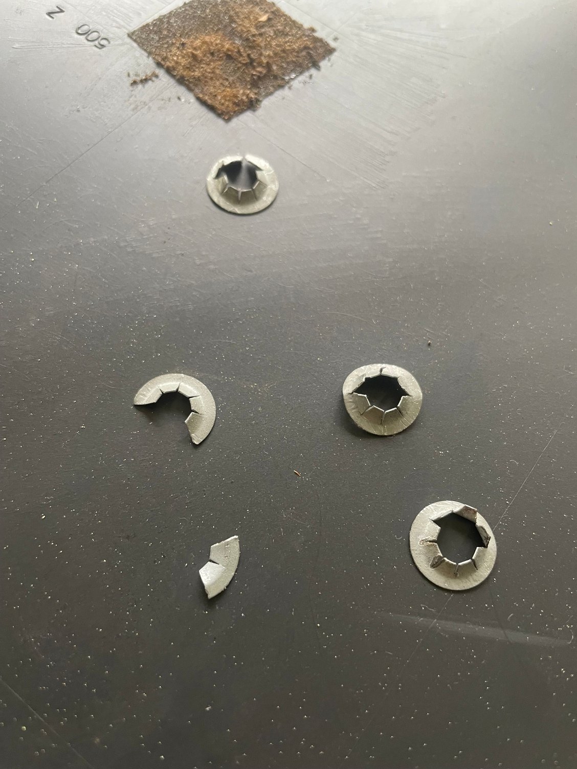

I'm reupholstering the front doors on my 2002, but the door panel has these clips that I can't identify. I managed to get them off but some didn't survive the assault... doesn't seem like these are meant to be reusable. Short of a trip to the u pull it, I'd love to know what they're called and even better, where I can get more.. ?

I don't remember the tricky name for them, but, I think you can get them at your local hardware store.....
Those are called push nuts. Fairly common. I usually use a socket and extension to push them on. Press down on the extension and they will often push right on.Although I have needed a hammer a few times. Dealer, hardware store, home improvement store and so on usually have them.

Thank you both! I found some and I'll post some pix of the finished doors in a day or two!

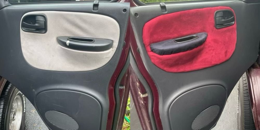

Finished one door... not the greatest, but much better I think. Thanks again for the tips. Here's a before and after...

Auveco Pushon Retainers. I hate those things! Hate 'em!
