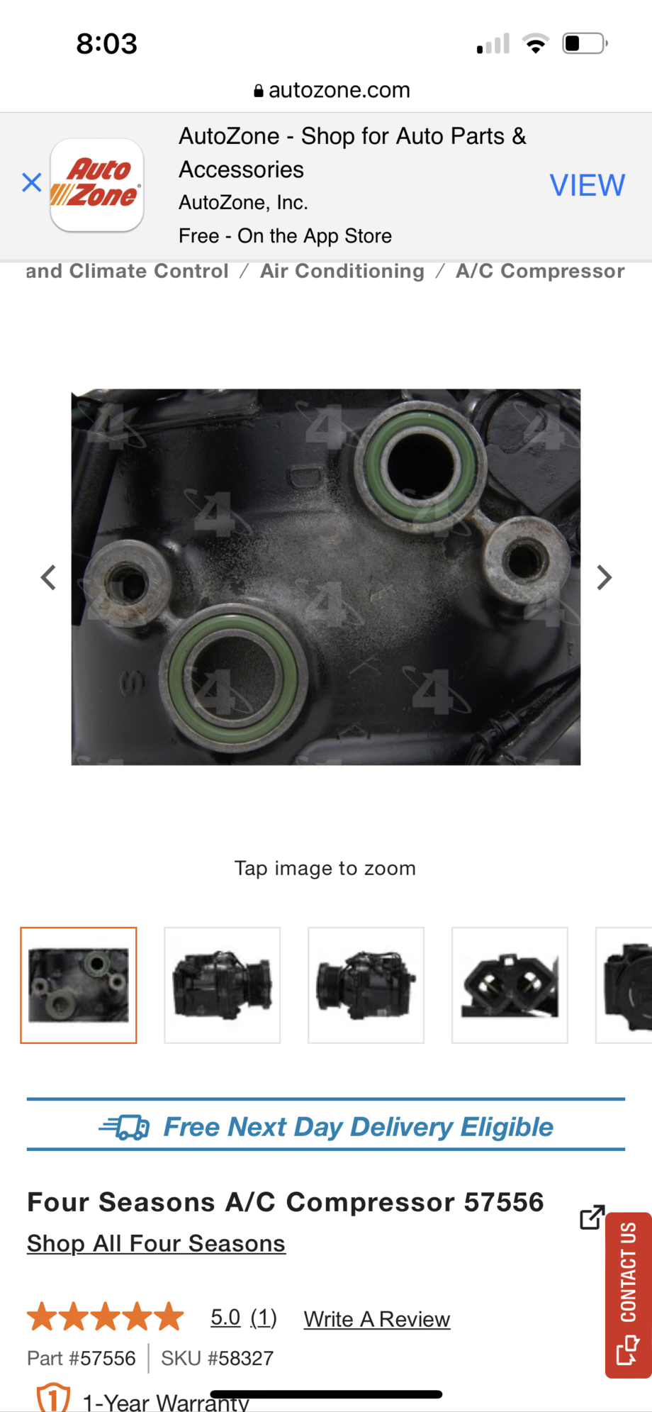

From my research, the compressor I have is:
Four Seasons part number 57556
Sanden/Sankyo TRF105 Compressor w/ Clutch
They are peanut fittings, with very shallow lips. See the photo shows how the suction and discharge connections are offset from each other? That’s kind of a unique style which makes finding a manifold impossible.
Anybody have experience with this compressor? At this point I’m considering bending my own aluminum and cutting the old fittings off and having them welded on at a shop. It happy about this though, because the fittings themselves are worn and a bit rusty so having new ones would help me sleep better lol.

I know your compressor is new.... but, have you considered taking the compressor from a truck, along with the lines, and adapting from there??

I’m going to try removing the old fittings with a torch and brazing them onto some new aluminum hard line.

Will brazing aluminum stand up to the pressure? ARE the lines aluminum?

Aluminum brazing is pretty standard with AC lines I’ve learned. Just torch and braze. I found a place nearby that’s helping me make everything connect and fit. They have a crimper for beadlock fittings so I can basically connect everything with minimal brazing. A lot of the fittings are SAE threaded too so I can just screw them together and rely mostly on rubber AC hose instead of aluminum.
Here’s hoping all goes well and I can pull a good vacuum!
