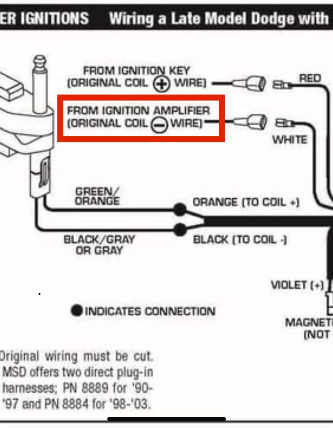

The wiring diagram I pasted last time was wrong as you pointed out, I'm sorry. Which wiring should I connect to the white line in the red frame of the wiring diagram attached here?

Negative wire going to the coil from the PCM(before you cut/splice).
