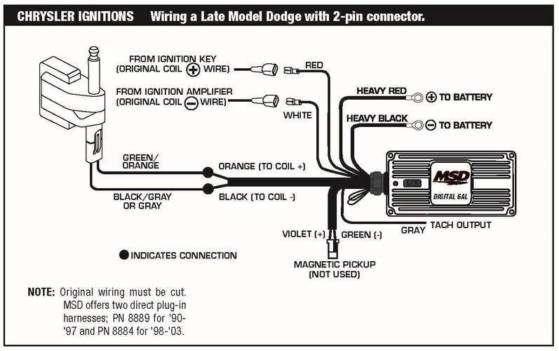

Originally Posted by nakamure
Everyone, please tell me. I installed the MSD 6A on the 2003Ram Van 1500 5.9L, but the white line of MSD says that it connects to the minus line of the distributor, but I don't know which line it is. I want you to tell me where to connect it. From Japan
Connect it to the negative coil wire as shown in this image.

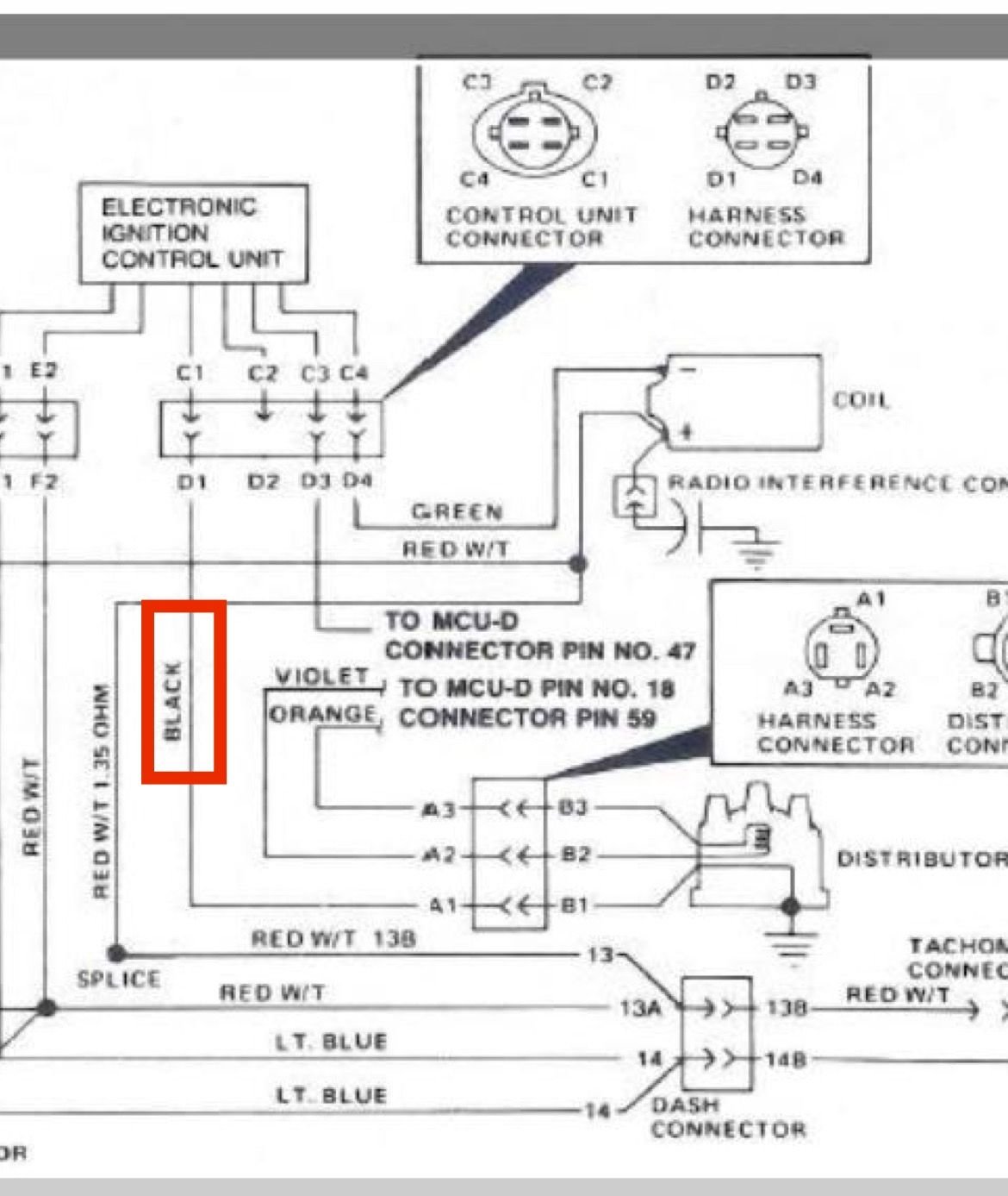

Default Isn't it this line?
Isn't it a black line surrounded by a red frame?
That's the pickup coil inside the distributor. The PU coil controls the fuel injector timing, not the ignition timing.
Old Nov 25, 2023 | 10:54 AM
Where did you dig up that print? The capacitor on the ignition coil was used back in the 70's. I had one fail and ground the positive lead. Connect it like the print shows.
A web search, here's the link to the full document.
https://documents.holley.com/6425.pdf
