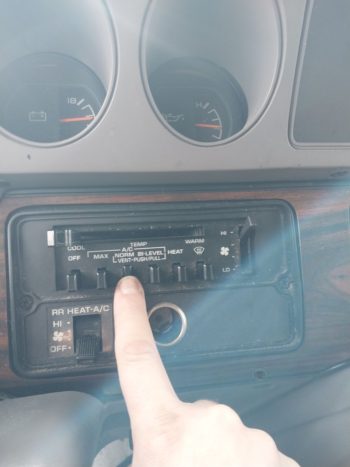

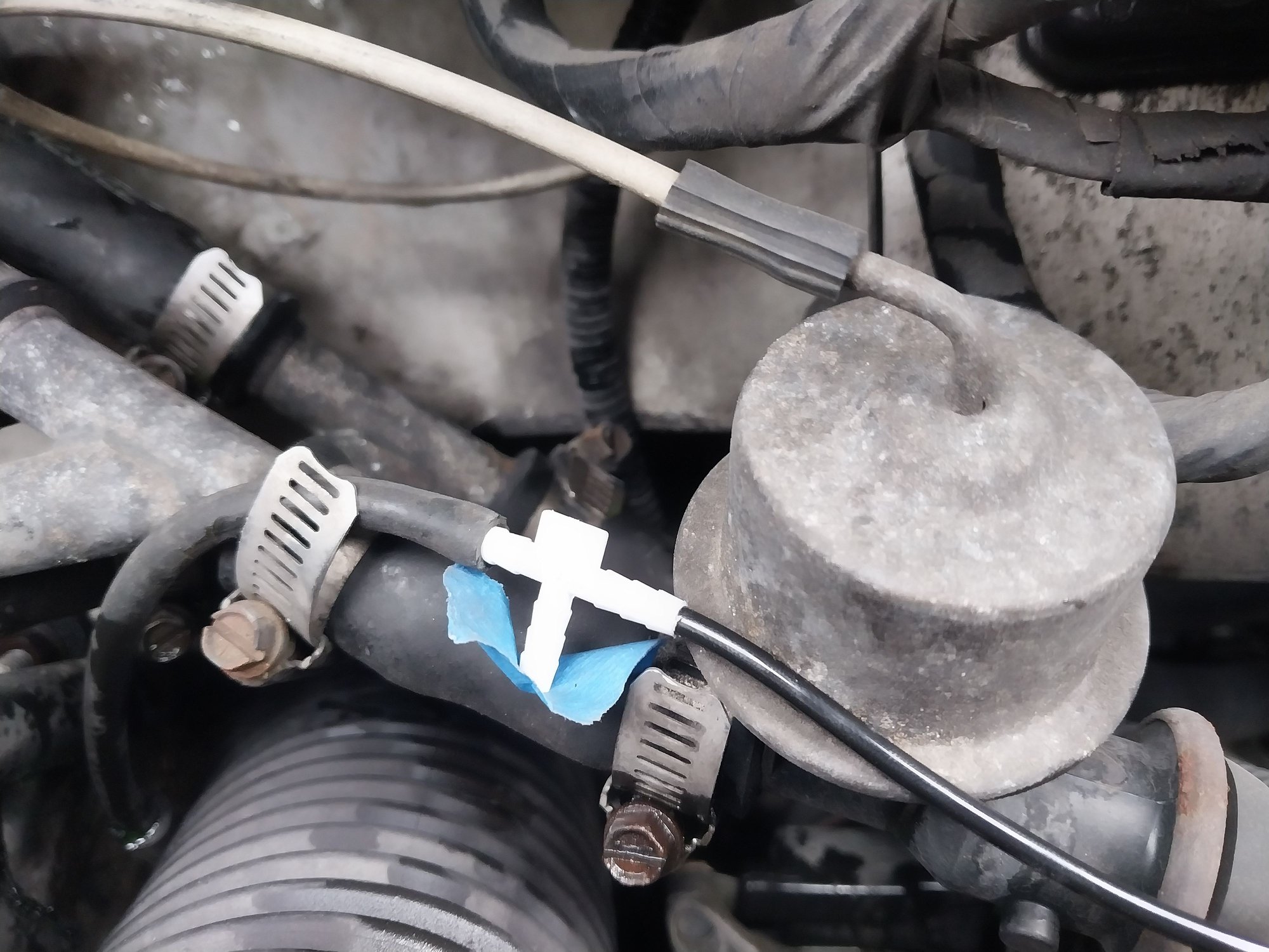

Me again! Lol. Trying to fix vac lines for vent control. This rigged job is temporary until I can make sure everything works. Anyway, every setting works except for max AC. SO before this broke, every setting used to work properly. Well I noticed the Max AC setting blows noticeably harder than the normal ac setting. My question is. Since I've repaired all of this, what would cause my max ac not to blow harder than normal setting? So like if I switch from Bi-level to normal it will have a noticeable difference in blow output from vents. But let's say now I go from normal setting to max ac setting, it used to open something that would blow even harder than normal. Now it's just blowing as hard as normal blows when it's supposed to blow noticeably harder. Any ideas as to why? Mind you the repair job is temporary until I can figure this out. Then I will tie it all up properly.
