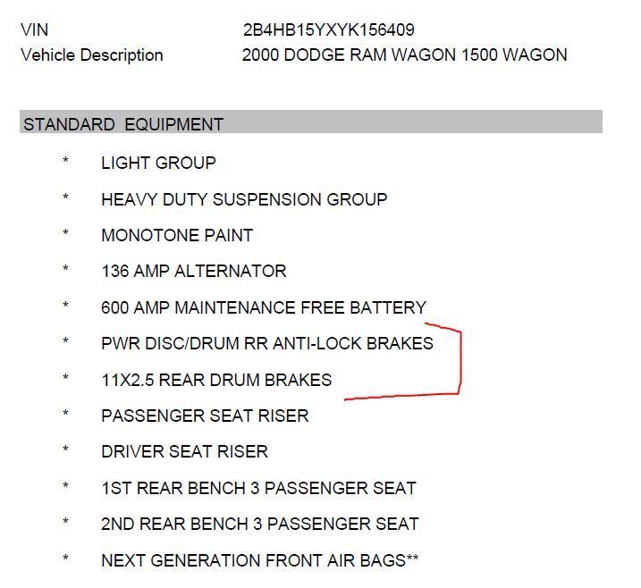

Not 100% sure on 2 or 4 wheel ABS. I'm guessing 2. Here's what the build sheet says:

Rear wheel antilock. I don't think there IS a control module for that, I think the PCM handles it all??? After all, its just a dump valve.
I believe there is, at least on the 97 to 2001 vans. Kelsey Hayes P/N 52009460.
