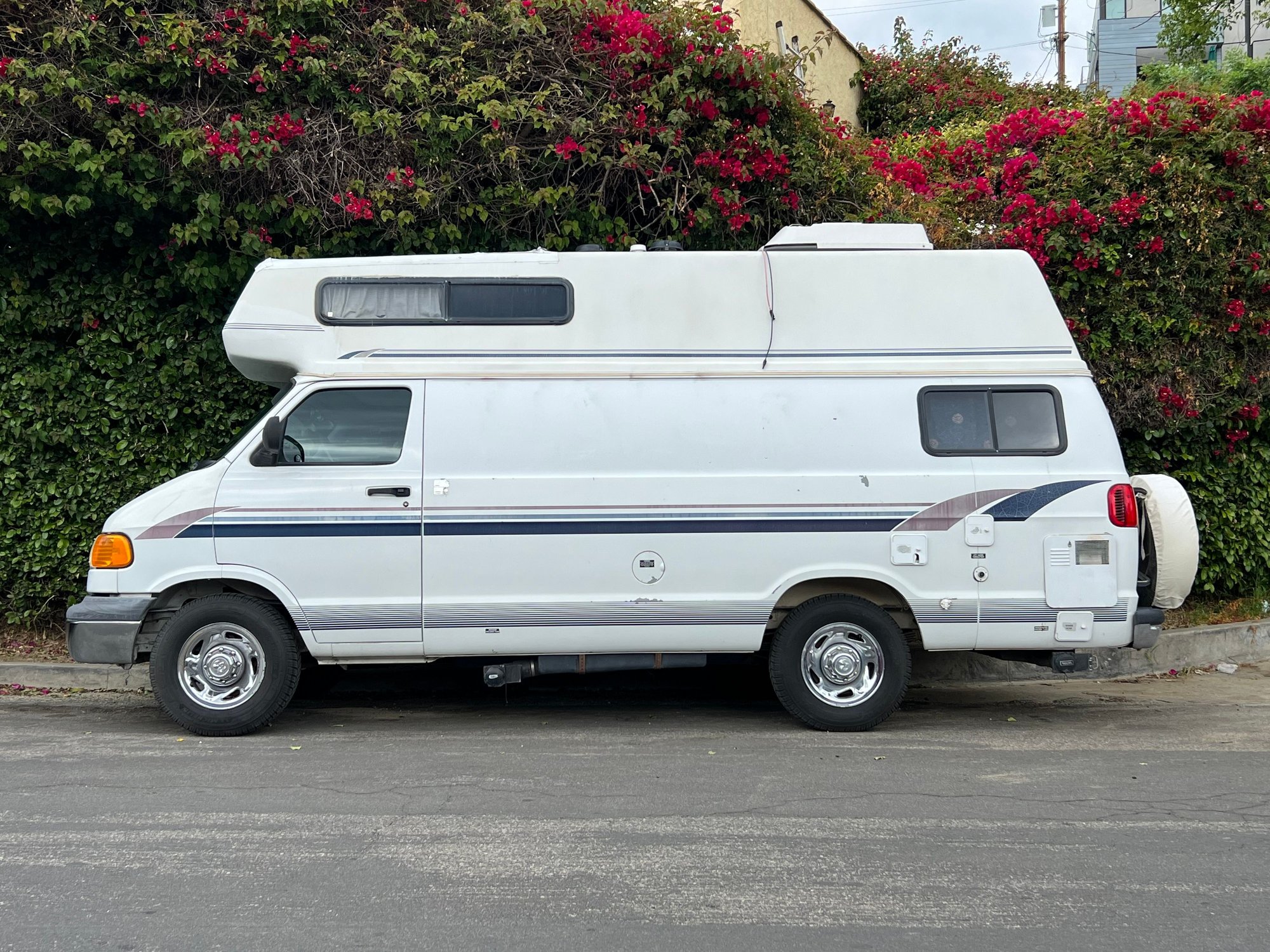

Hi! I'm wondering if anyone here has experience with Timbren Suspension Enhancing Jounce Bumpers. I see them for sale, but I can't find a single video or picture of them being used on a Ram Van.
Occasionally, on the freeway, my campervan (pictured) encounters a bump or dip which puts the van down on the bump-stops a little harder than I'd like. Just wondering if these Timbren things are a good solution to that problem.

I have the Timbren model DVF350 on my 1998 Ram 3500 campervan. They do provide a firmer ride at the front, and solved the occasional hard impact that you describe.
One thing; the instructions mention that the front rubber springs should be in contact at normal ride height. if you have the optional 4,000 lb. front axle, you will also need the rubber spacer disks, which are not included with the standard DVF350 kit. Without the spacers, you will have about a 1/2" gap, and a bouncier ride. Timbren sent me the spacers - and longer bolts - at no extra cost.
