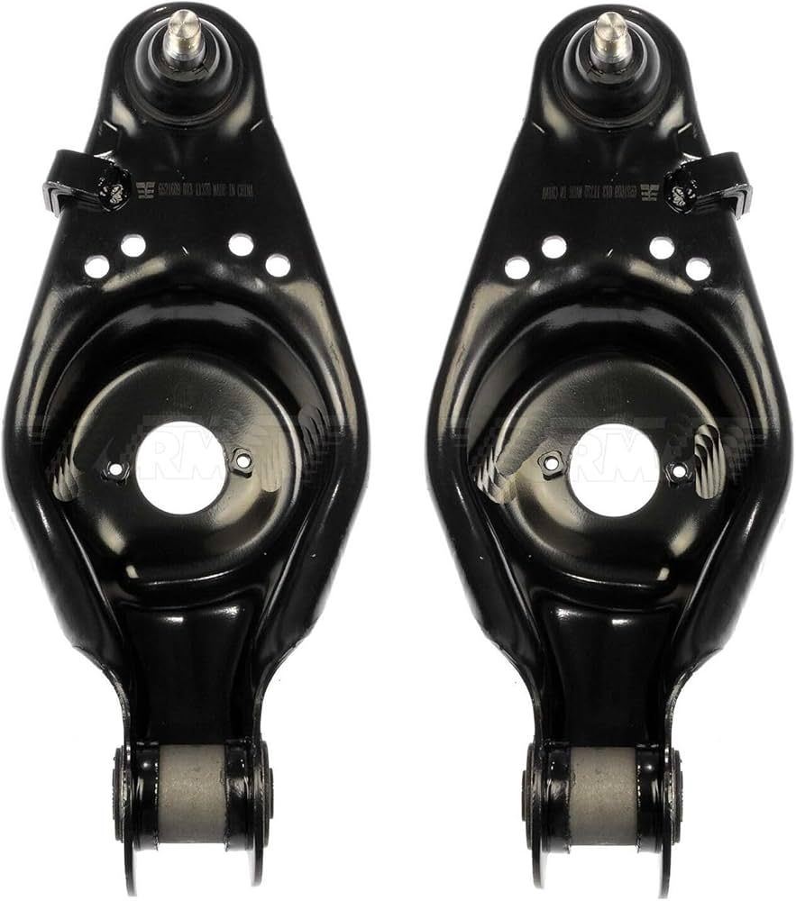

If your lower control arms have four holes (as pictured), then you have the heavier duty (and rarer) 4000lb Front Axle.
If not, then you probably have the 3600lb Front Axle.
There are also distinct differences between the two in regards to tierod length. If you aren't sure, just post a picture from under the front, showing tie rods, drag link, etc.
