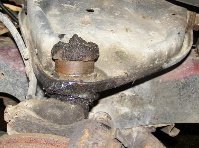

Not the way it should be! Here's what I found - the ball joint has worked its way right out of the top wishbone.
Is this a common occurrence? And I've been quoted about $500 to fix it, is that in the ball park for this job?

The threads are stripped, so the upper control arm and the ball joint have to be replaced, plus labor, then an alignment...so yes, $500 seems quite reasonable.

What threads are they?
This is a press-in fitting, I'm sure, the sides there are dead smooth, they've never had threads.
Old Nov 5, 2024 | 10:28 AM
Posts: 87,475
Then there should have been a snap-ring, or something, to hold the joint in place. If not, then the whole in the a-arm has become oversized, either due to movement, corrosion, or simply age, and still needs to be replaced. Generally though, on press-fit joints, the uppers would press in from below....

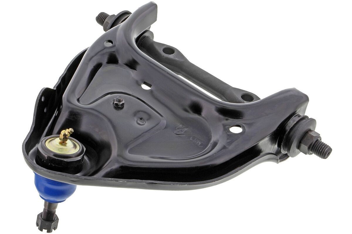

I wonder if someone (wrongfully) pressed in a (wrong) balljoint into the normally threaded control arm. Your control arm looks exactly like this 1999 Ram Van 1500 control arm which clearly uses a thread-in ball joint.

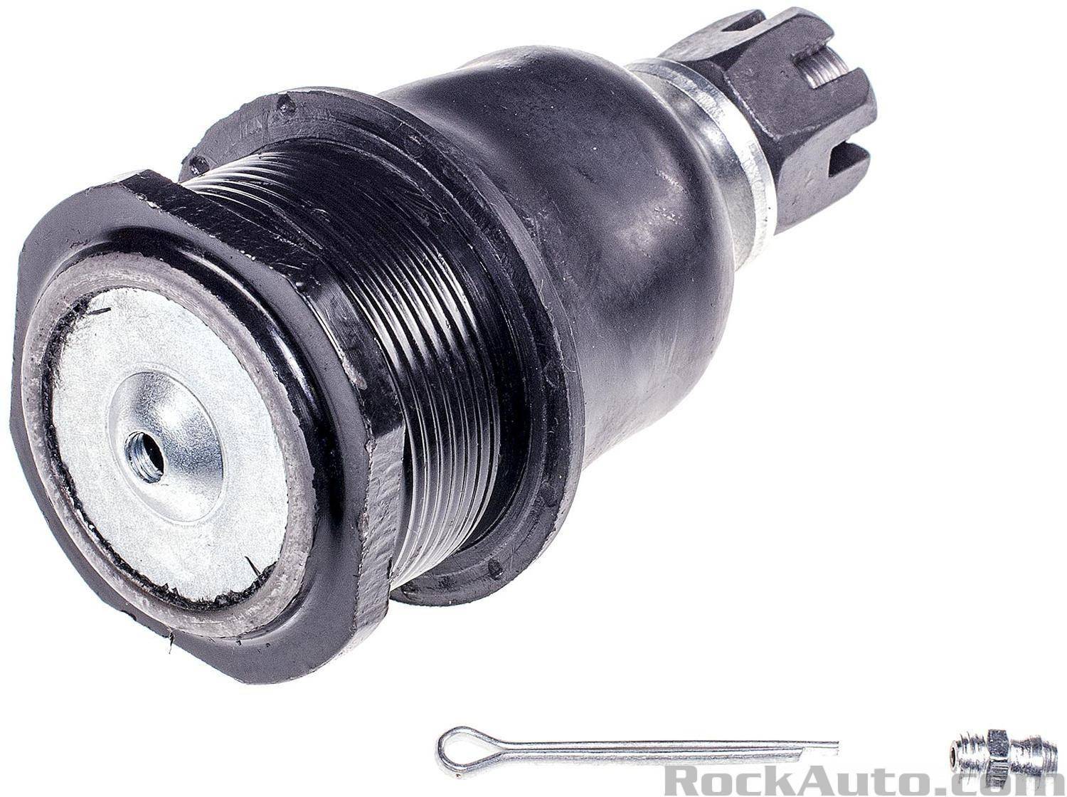

If you clean off the ball joint you will see it has 4 flat sides. The threads are very small, but they are there. A special socket is needed to thread them in and tighten them.

It's been at the repair shop for two days, I went in today and yes, it does have a thread. My apologies, it had been full of rust and I couldn't see it in my hurry to get it booked in.
The hole, they said, has been expanded by the experience and a new wishbone fitted. Tomorrow morning they wheel align it and the job will have been completed. $580.
