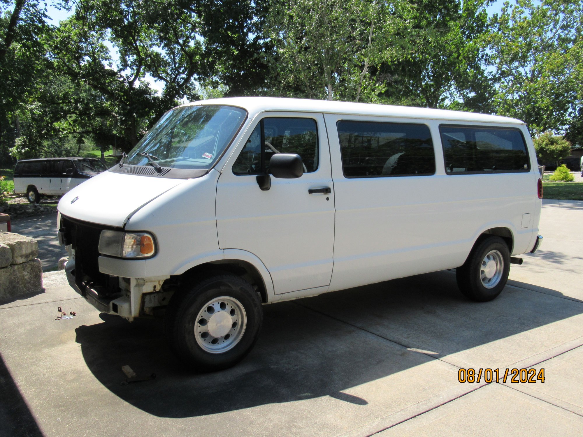

I have a set of the aluminum bullet holes wheels I would sell. They came on the 90's pickups and vans. Couple of buts, only 3 center caps and I doubt you're close enough to pick them up. Here's what they look like with the flat center caps.

Are those stock tire sizes? I was thinking of going 16s

If you are referring to the picture I posted then yes those are the stock size tires and wheels.
