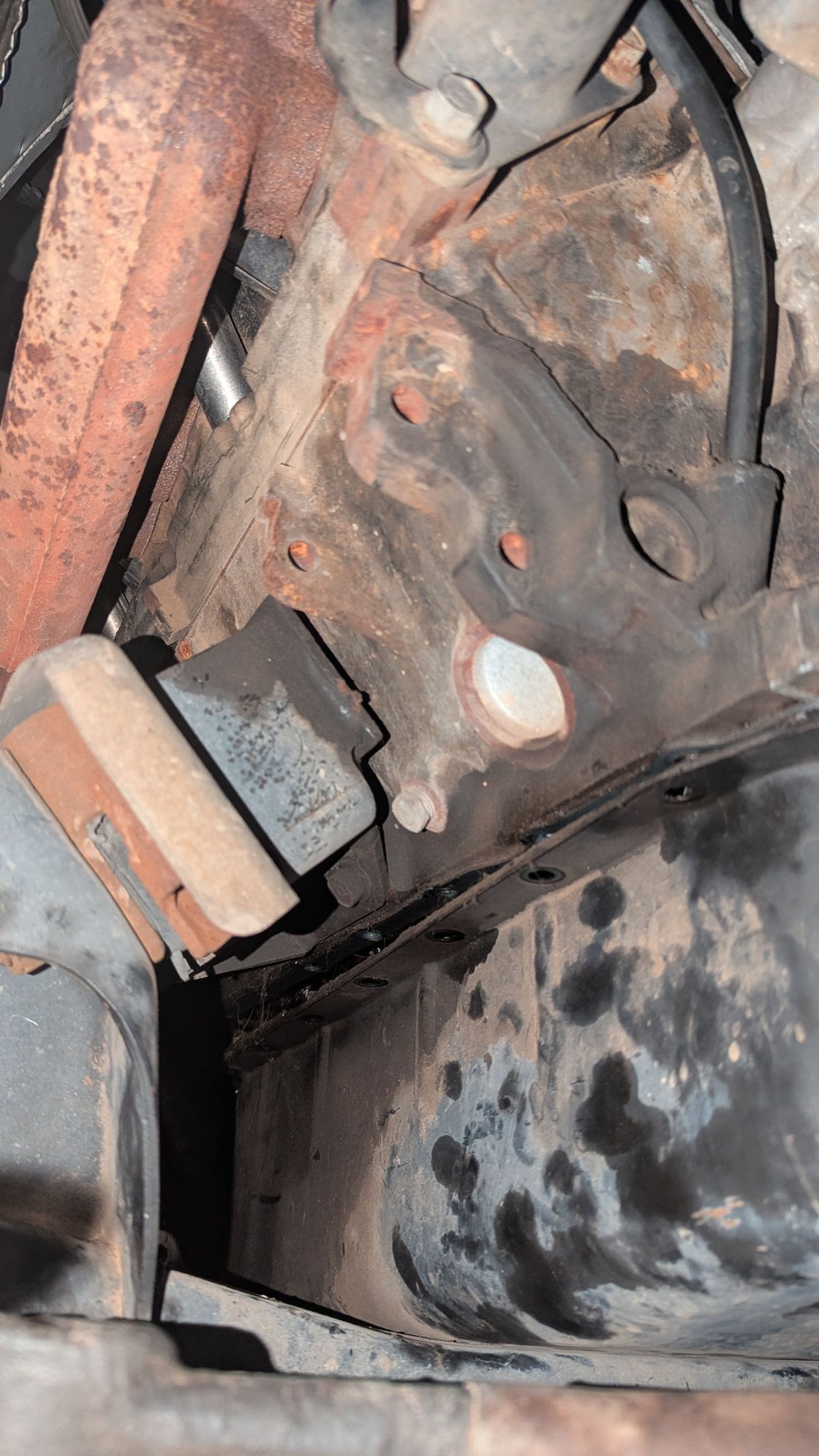

Here's some big holes near engine mount 3 on passenger shown and 4 on driver side. Maybe can utilize those for jacking up engine or holding it up when dropping crossmember? (Since engine mounts are attached to crossmember) I presume those were for moving around engine at factory or something?

I did loosen motor mount bolts. Plenty of clearance to jack up motor a few inches so not sure why it was lifting up chassis unless mounts where stuck? Was afraid to jack up on harmonic balancer much but idk how else or where to do it. However, i still wouldn't be able to drop oil pan without dropping cross member.

I jack 'em up by the pan, then toss some wooden blocks of the appropriate size between the engine mounts, then drop the pan..... Of course, that was not on a dodge van......

I place two equally sized pieces of 2x6 on my floor jack, one in each direction so that the grains are 90 degrees apart. Slide it all under the oil pan and jack it up, just enough to start taking some weight. Remove the doghouse and the air cleaner assembly. Then loosen the transmission mount bolts about halfway out. From there, unbolt the top or bottom half of each motor mount, whichever is easier to get to. Now you can start jacking the engine up. Keep an eye on the fan, wires, and hoses to make sure you aren't stretching anything, if there are any, loosen them up to gain slack. Keep jacking it up as high as you can get it, then insert blocks of wood between the block and the crossmember. Lower the jack until the blocks of wood take the load. Remove the jack and the 2x6s, then start removing the pan. Keep in mind, the oil pump pickup tube goes to the bottom of the pan. That is what you'll get hung up on if you can't lower the pan enough to get past it. It is possible to gain more clearance above if you remove the belt and unbolt the AC compressor. You do not have to disconnect the hoses, just pull the compressor forward enough to get it out of the way of the firewall.
