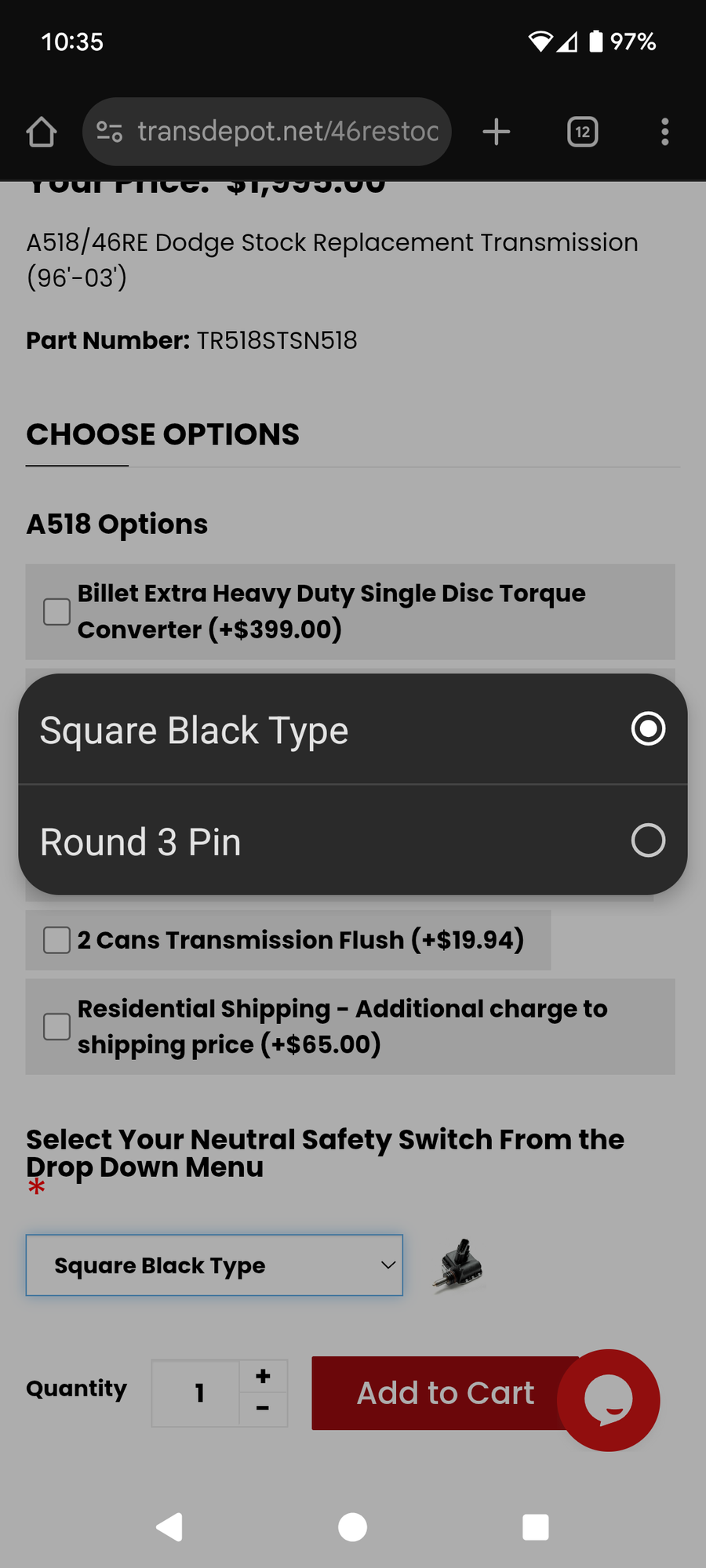

Are we all sure the 46RE didn't come with both?
I've had issues finding neutral safety switch for the 46Re because of this and they did make an adapter but believe it was to go from 5pin to 3?
I also was looking into getting a rebuilt 46Re a few days ago and it asked which switch i want.

Posts: 87,483
Yeah, the PRNDL in the cab changed at some point, so the switch had to change as well, so I could tell the dash what to display.
