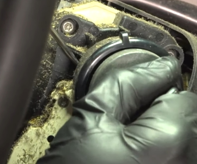

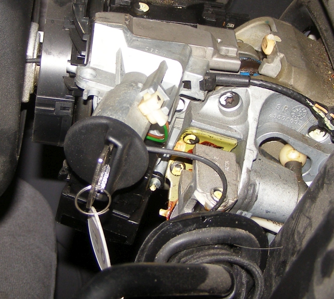

I stopped by the U of Y to check with the perfessors. (Youtube.) I'm pretty sure your ignition switch is the same as the pickups. This is how I replaced the switch in my '96 Ram 1500 last year.
See if this helps. If you have RHD, it may be different but if you have an LHD van, it should be similar. I can't see the steering column being different on a van than a pickup.
It's different...
Look at my pictures and compare.
The pickup from the You Tube clip:
My pic from a similar angle:
However, as I noted in a previous post, there is some fiddling about with a tab of some sort and I think this might be the key to mine. BUT THIS CLIP DOESN'T SHOW IT!
If anyone can find the You Tube clip for the right one I'd be delighted. I've looked at many and they're all different.

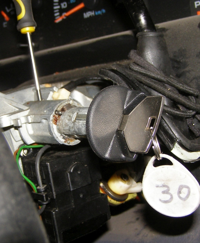

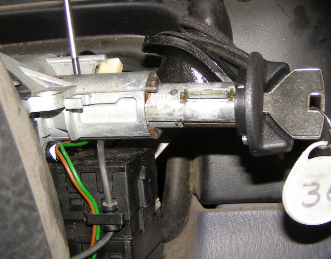

So the correct lock position for the pressing of the sprung hold-in piece is in the 'START' position...
Then it has to be turned, will still holding the pin down with a thin item (instructions were a 1/16" pin punch, I used a T10 screwdriver) the key has to be turned to the 'ON' position...
...and the lock withdrawn. It took e a few goes to get it right but I got it.

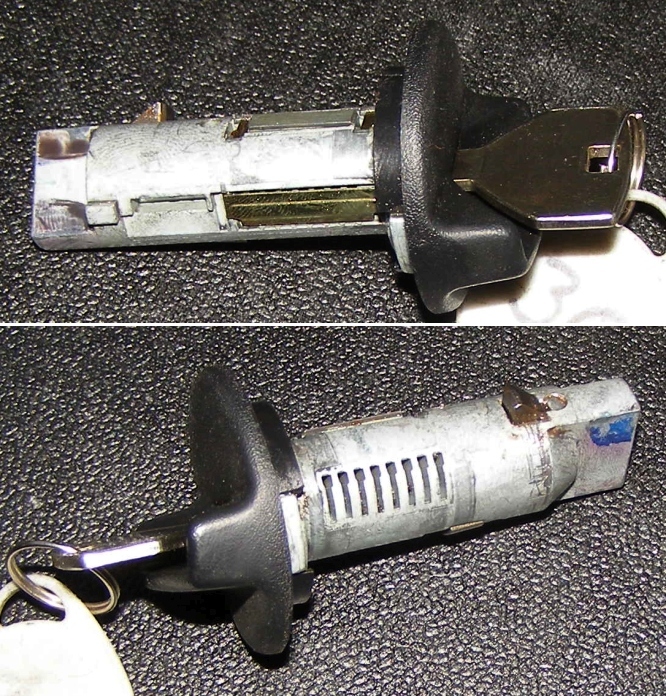

Note that the barrel is totally unlike any of those in the You Tube videos, or for sale on eBay?
It's now out...
It cost me money, but in desperation I went to 'Just Answer' online (I hated doing it and didn't expect to get the answer) and there we are.
My thanks to all who have tried to help, now it's up to a locksmith I guess.
