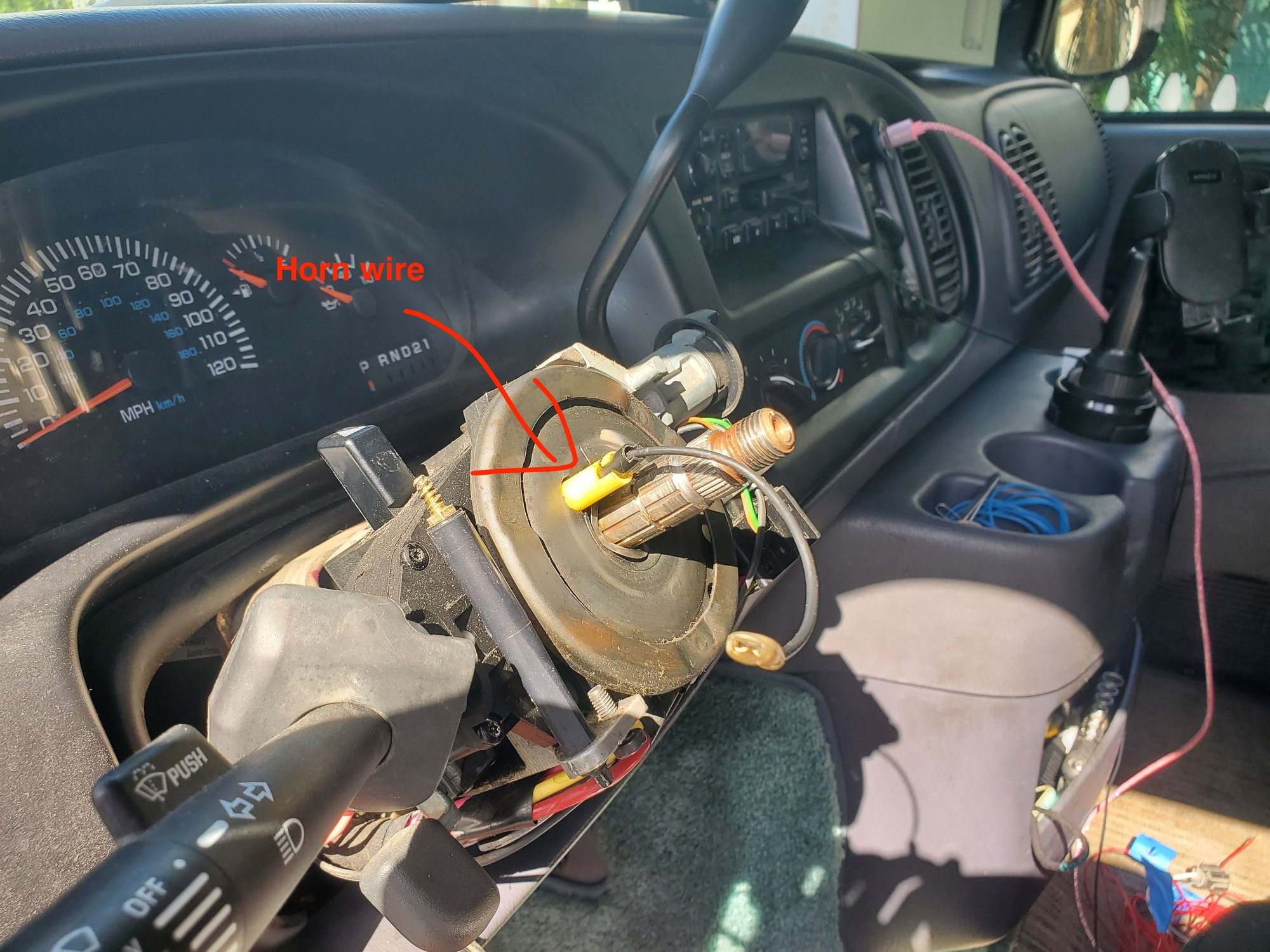

Thanks HY - seems like clock spring is the culprit. With airbag removed, I checked continuity between the yellow airbag pins and the yellow connector under the steering column. One airbag pin had continuity to the yellow connector, the other did not. Sweet.
So I bought a replacement clock spring from Parts Geek (958-137). But this replacement unit has a different pin out where it plugs into the main harness (5 pins instead of my original 4 pins) AND the horn wire is integrated into the new unit, while on my original unit, the horn wire is not attached to the clock spring at all. It just passes through a hole in the unit (see photo). To install the new unit, it looks like I'd have to rewire the horn off an un-used pin in that 5 way connector, and maybe break off the yellow plug that horn wire emerges from. Anyone come up against this yet? For the life of me, I cannot find a replacement clock spring that looks like my original. Original part number is (56021956 AB). I also managed to mangle the original unit getting it off. Naturally.

Closing thread. Junkyard had an intact DRV with working clock spring. No more airbag light and cruise control works for first time ever. The new units you can find online won't fit the van's steering column. So junkyard or nothing.
