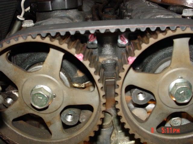

i put thecrank to 5 degrees and the cams are of about 1 inch and ahalf offbut i changed the computer and the engine runs great with spark on all cylinders.thanks for the help thestealth it is much appriated any idea on the timin though and why the car would run so well
Old Sep 12, 2007 | 11:27 AM
thestealth's Avatar
thestealth
Joined: Feb 2004
Posts: 3,640
From: United States
Default RE: timming slip
All 4 cams are off that much? Wow, honestly shouldn't run well at all...that's weird.
Here is a picture of how the cam timing marks should line up.
http://img.photobucket.com/albums/v6.../60ktune04.jpg
