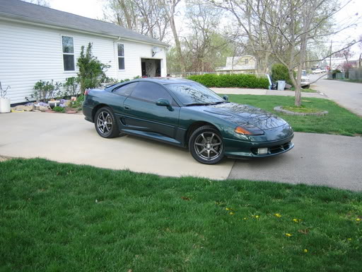

The wheels on my green car are +42 offset if I remember correctly. I picked them up from wheelmax for right around $1000 mounted/balanced and shipped.
