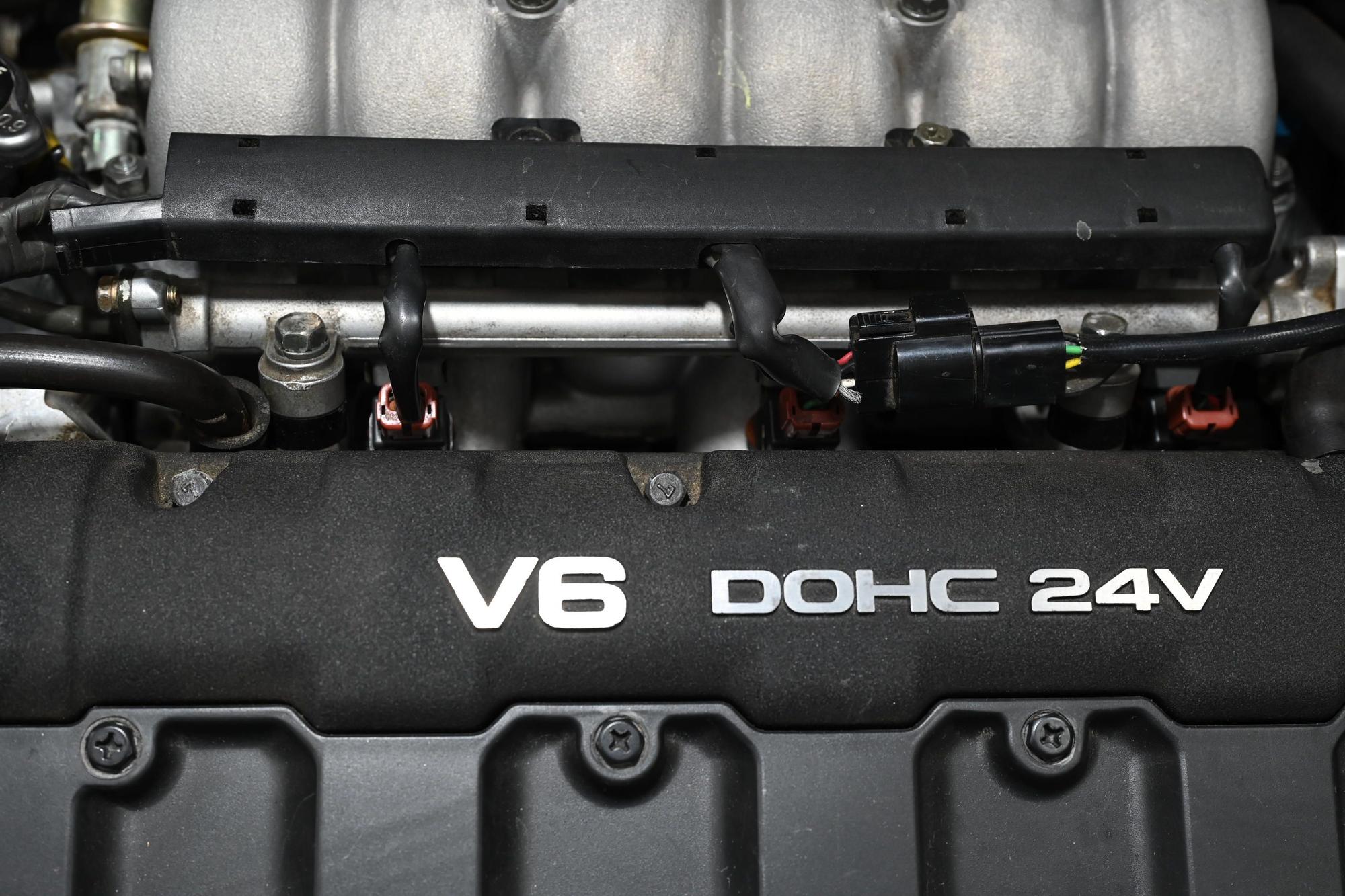

I have a '91 R/T Twin Turbo that has been throwing the fuel injector-harness code for a while now, that I haven't been able to track down. The car runs fine, I've had the plenum off a couple of times, and had the fuel injectors cleaned twice in the process. I just noticed this bare stranded wire sticking out from the insulation wrap at the middle injector. There is no place for this wire to connect to anything; it just sticks out from the insulation, as you can see in the pictures. It's not just a loose wire, it's a grounded wire. Does anyone know what his wire is?

Four wires there, one for each injector, and a power feed. PCM controls the ground.
