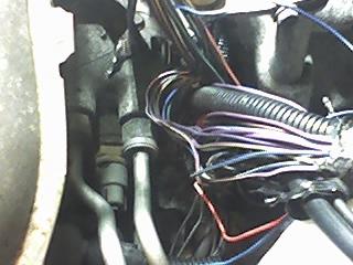

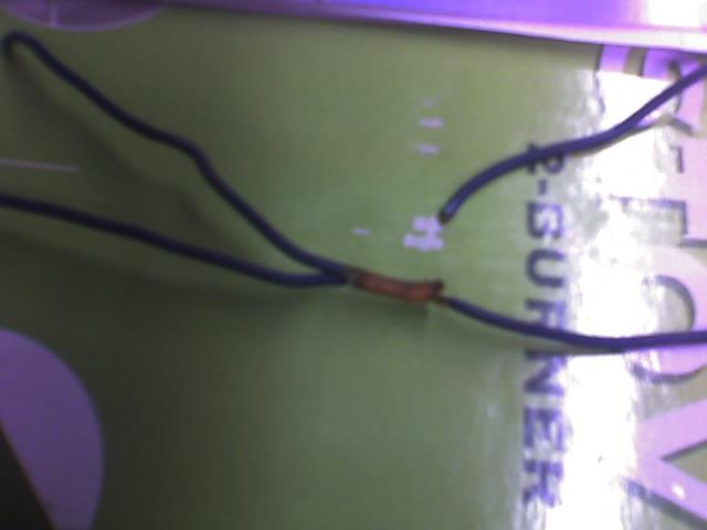

If you're seeing that many sensor codes at one time, chances are it's not the components, look at the harness grounds ( probably a blue wire) I was having similar trouble with my '06 T&C 3.3. It would do the same thing intermittently, and after extensive research and many replaced components I have found this to be a common problem with FWD wiring harnesses. I found the break in a factory splice where the harness splits to circle the rear of the motor. Apparently Chrysler can't afford solder for splices and instead uses a glue and shrink wrap method. I have some pics of the actual location and splice i will post up later.
Attached Thumbnails skipping problem-harness1.jpg   skipping problem-harness2.jpg   skipping problem-harness3.jpg
