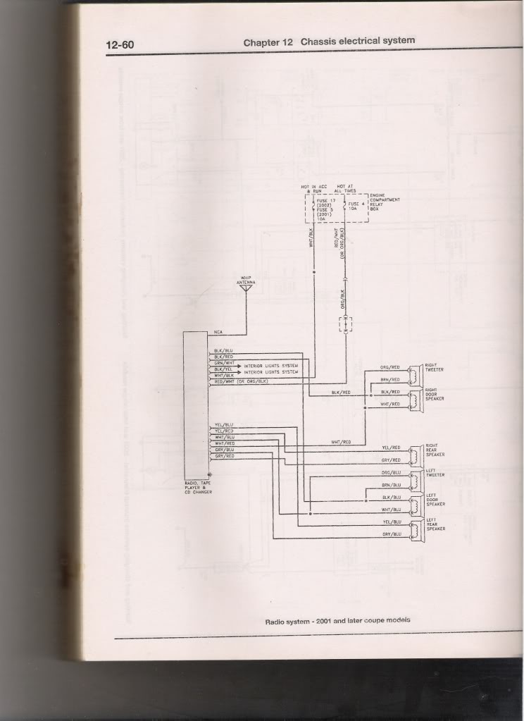

i need to know the stero wires color code for a 2004dodge stratus sxt coupe. thanks

the colors on that link dont match up. here are the colors that i have. white/black stripe,black/ yellow stripe, yellow/red stripe, grey/blue stripe,white/red stripe, grey/red stripe,white/blue stripe,yellow/blue stripe, green/white stripe,black/ blue stripe, black/red stripe,red/white stripe. thanks for your help

Its small but should work. A scan of the Haynes manual

thanks for your help man. thats what i needed
