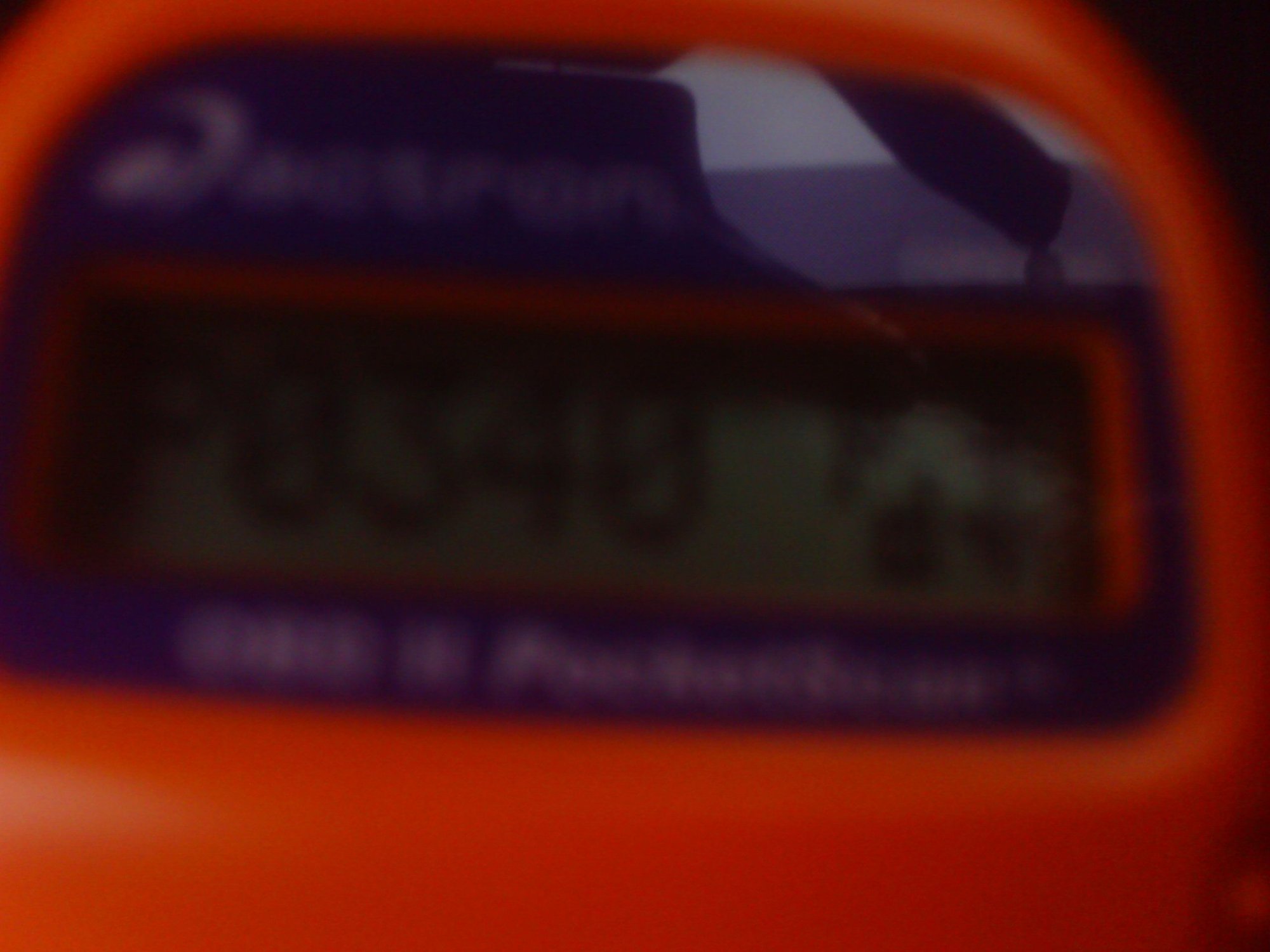

2004 dodge stratus sxt 2.4 single over head cam
scanned, found 2 codes... 1 for cam sensor and 1 for crank sensor
keep driving till one day at store it wouldnt start when i cam out, pulled it home
Replace cam sensor and the car started cleared codes but they both came back on with in a block.
Garaged car and removed timing cover thanks to this forum i found the crank sensor behind the lower timing cover as in the pic below:
The i noticed a smaller belt that runs behind the timing belt (destroyed), it looks like it should ride on the pulley but the spot it should ride was not shiny, it was kinda rusty so it may have been like that a while.
so now i think not only should i replace the crank sensor but the timing belt and pulleys,,,,what do u think?

Ok im stumped replaced both the cam and crank sensors and cleared codes . After stepping on the gas the check engine light comes back on (it actually say it found 4 codes
but they are the same codes po335 and and 340 only the the second set has a pd next to them.
While changing out the crank sensor i replaced the timing belt and 3 pullys and the balancer belt which caused oil to gush out on the floor. ( well it didnt do that before)
So i took it all apart and left off the balancer belt and the oil leak was gone
The car runs fine but that darn check engine light is still on... any ideas?

yes the battery was disconnected during all r&r work, warmed up engine and scanned and cleared several times once cleared light would go off then come back on when i rev-ed it up.
I will look it over and see if i notice any bad connections or wiring.
