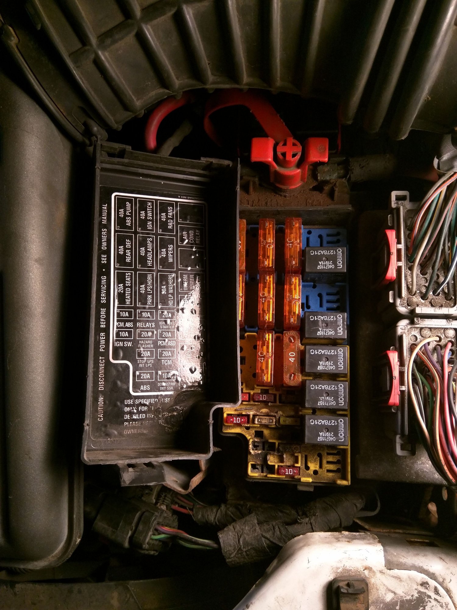

No luck disconnecting the negative battery terminal. Looks like these components all go through the IOD fuse, which I haven't been able to locate anywhere. Does anyone have an idea where it is?
I found 2 spots for 10 amp fuses and tested a relay hiding under my steering wheel but they were all good and look like they went to some old after market security system.

Everything works now! It turned out that my 3 components that weren't working (power locks, radio, and dome light) were all run through fuse number 4 in my engine compartment fuse box. It was just labeled to run "stop lps and int lps" and the fuse in it was good, but it wasn't making a connection.
This problem is completely unrelated to my asd/pcm trouble, but when I first went through everything I noticed that some of the fuses were nasty and corroded so I replaced them all, I guess the old fuses were still working fine but the new ones didn't connect right. Long story short I clean the holes out for the fuse and bent the prongs around until they made a consistent connection.
